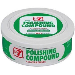

rubbing compound is harsh. at the most, i would go with polishing compound. think of it like grits of a paste-like sandpaper. rubbing compound is the harshest, polishing is medium and wax is the finest.
