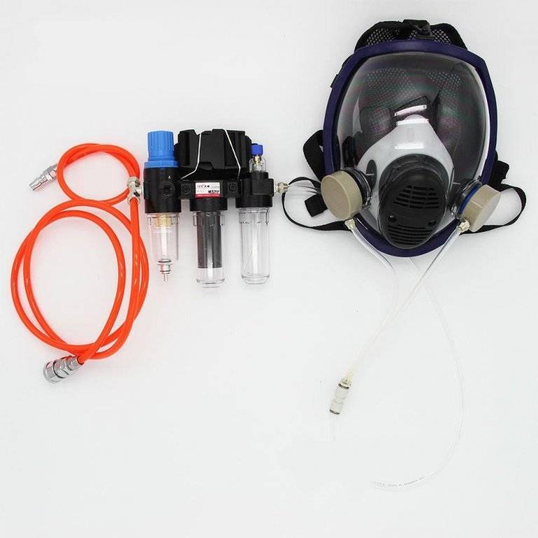

Anyone used this style of Supplied air?
RCB
Jan 15, 2017
234
70
Indiana
I saw these and wondered if anyone has used this style. It hooks up to a compressor and uses an oil water separater. A bit different than the style I'm used to seeing.
I think if I was going to use one I'd want an independent compressor for breathing air only.
There are portable kits like this made to plug into a regular compressor system.
Does it say OSHA approved anywhere in the package? There are very specific air filters required for breathable air systems.
Can't see myself breathing air from the shop compressor. There is crap in it. See all that sludge when you drain it? Oil.
