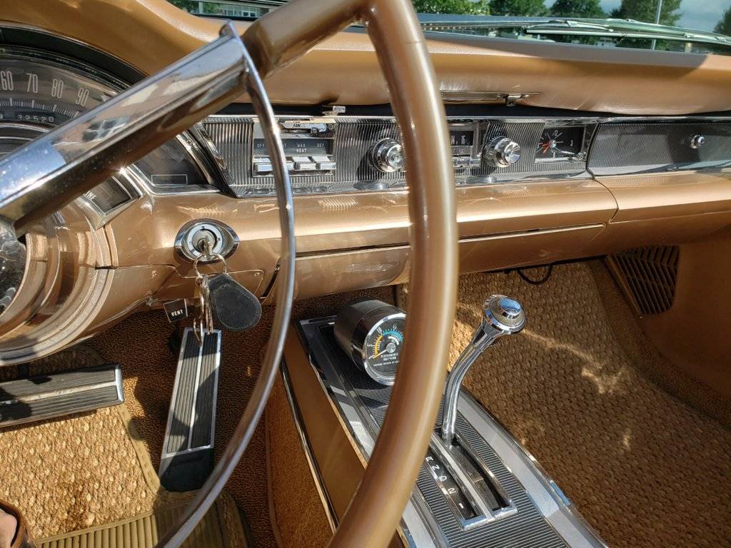

I have time waiting for a tow. My system wasn't charging and I have a dead battery 30 miles from home. Last fall it did same thing, I had a brand new electronic voltage regulator on the shelf installed, no other problems until now.
I haven't diagnosed that it is the regulator but can a bad alternator fry a regulator? If it is bad it would be my 3 in a year and a half.
At least the morning sun is pretty on the dash.
I cannot answer your question, but at least you've got a nice morning to enjoy. It's been raining here.

Nice instrument panel paint and chrome!
