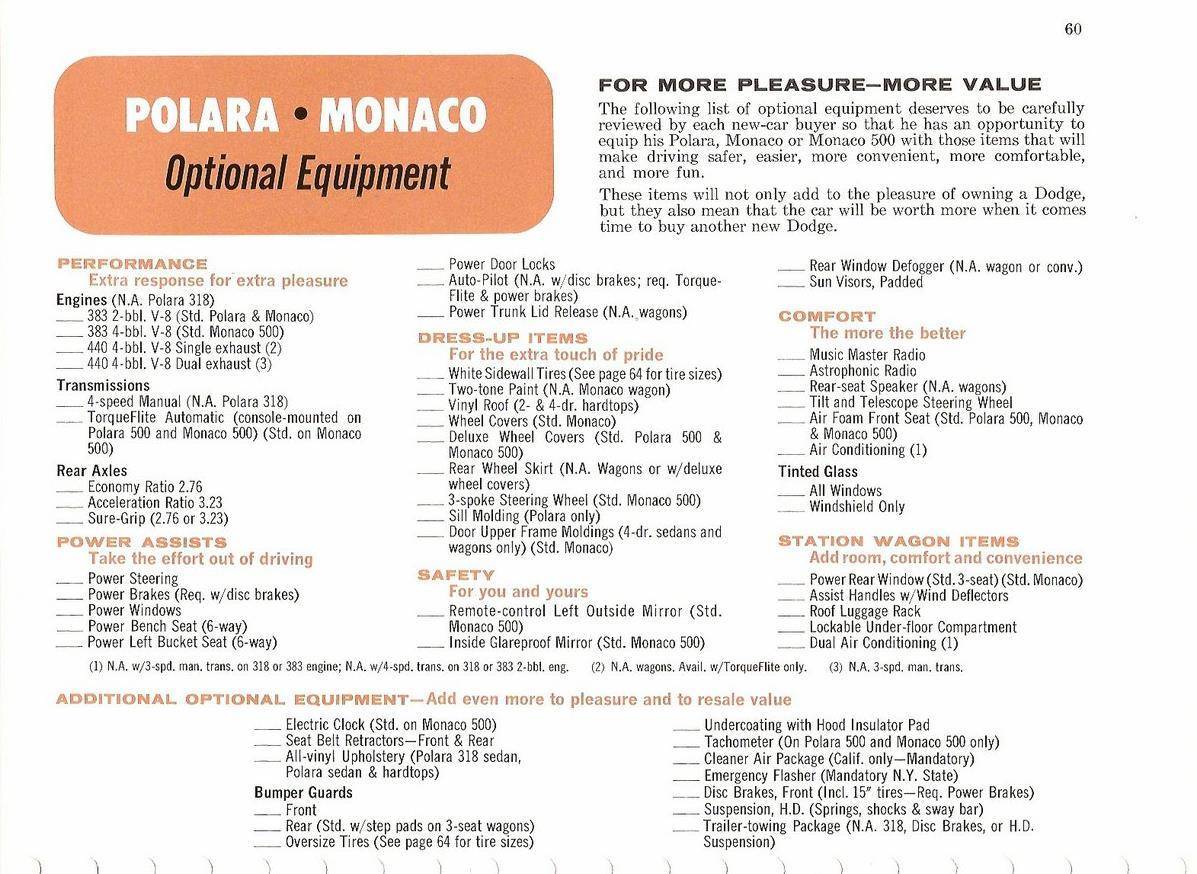

Hazard flashers was an option in Canada in 66. Mandatory by law in 1967.
'66 Polara brochure shows "emergency flashers" as OPTIONAL. See bottom section.

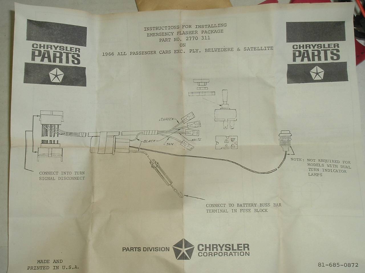

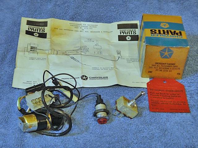

I installed mine under the emergency brake release. In my box of parts I had an option kit for the flasher and wiring. These were photos I downloaded for my flasher kit . If I can get to my car I will get a picture of the install location.

I installed mine under the emergency brake release. In my box of parts I had an option kit for the flasher and wiring. These were photos I downloaded for my flasher kit . If I can get to my car I will get a picture of the install location.View attachment 71917 View attachment 71916
