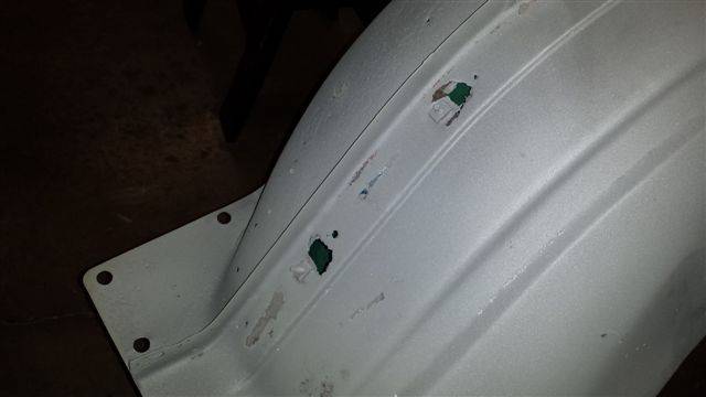

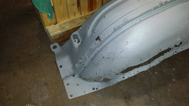

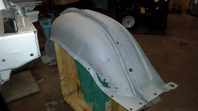

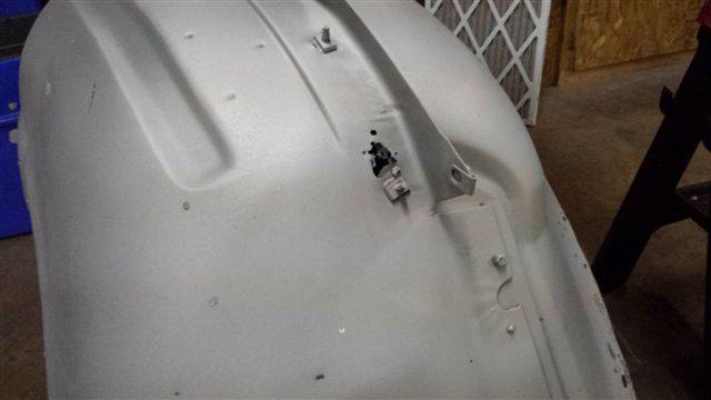

Are the 65 & 66n inner fenders interchangeable on the Polara/Monacos?
Mine are pretty bitten up from previous rust.
I can get a pair at a great price from a 65.
I've tried looking online but haven't found anything to indicate for sure they can be interchanged.
i can repair these but if I can get a pair in good condition, why go to the trouble right?
Your advice is greatly appreciated!
