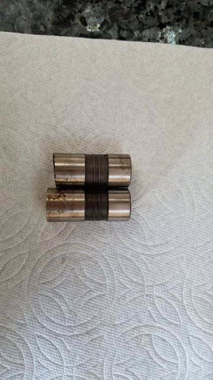

MEV - "I personally feel a roller cam is a valid and necessary expense. I have seen too many flat tappet lifters fail. Usually they fail on startup, even with zinc additive, and breakin-oil."
OK, photo of the lifter shows a result, but what was the cause? People are all to quick to fault the lifter when in fact it was something else. Then they blame the oil. "While having an adequate level of ZDDP content in the oil is important, examination of those engines with camshaft and lifter failures finds that those failures are more often the result of other issues not related to the Zinc/Phosphate levels in the oil. Current available oils if properly selected based on the information in the API bulletin do still have adequate amounts of Zinc/Phosphate for the older flat tappet camshafts. The key here is to know which oils have had the Zinc/Phosphate amounts reduced and which have not. This essentially means reading beyond the first paragraph of the API bulletin to get that information."
READ this long list of some causes that can damage a lifter & cam- Camshaft and Lifter Failure Causes | Eaton Balancing
