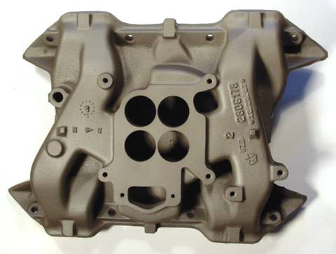

    I have located the supposed best stock intake mopar made for a 440 to replace the 1973 intake on my core engine I just bought.. This is the same intake that is on my present 440. That way all linkage etc and stock dual snorkel air cleaner I know will fit. Later I can swap out the intake if I feel the need. I want to concentrate on the bottom up. I can always add a fancy intake ,or headers later. Headers for me is the very last resort. So a stroker bottom end ,likely a roller cam and aluminum heads and carb.
    And just to piss you all off points ignition. [I can always change that easy later if need be too.] Halifaxhops said he could set up a nice distributor with a setup mechanical advance on his Sun dizzy machine.
    440 source description of the intake manifold I will use.
    The 2806178 intake was used on all 440 4 barrel engines from 1967 through 1969, on both standard and high performance models. Because of the years and engine this intake was used on, it is considered one of the best "muscle car" intakes. SHOWN FOR INFORMATIONAL PURPOSES ONLY, NOT AVAILABLE FOR SALE.

    @Turboomni that's not the best intake. Likely the best intake is the 73 intake, you already have or later. The Mopar performance M1 dual plane was a copy of the EGR spread bore intake, it had the most interior volume of any RB intakes, and it was cast in aluminum.
    I have a 69 HP intake if anyone wants to buy it.
    Duct tape the intake ports on both intakes so they will hold water, you will also have to do the EGR valve on the 73. Then "borrow" your wife's measured pitcher from the kitchen and fill each intake with water noting the volume to fill each and I believe you be surprised. The earlier intake also has sharper corners on the turns from center to ports.
