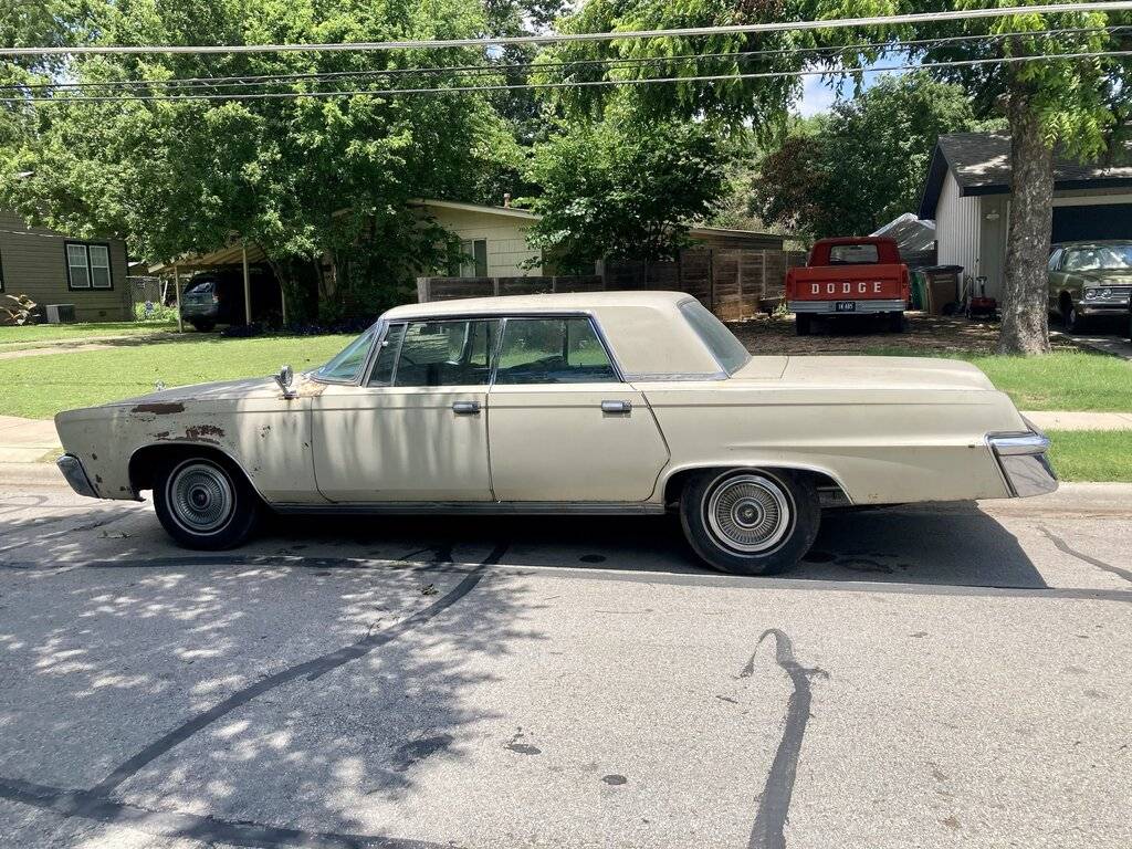

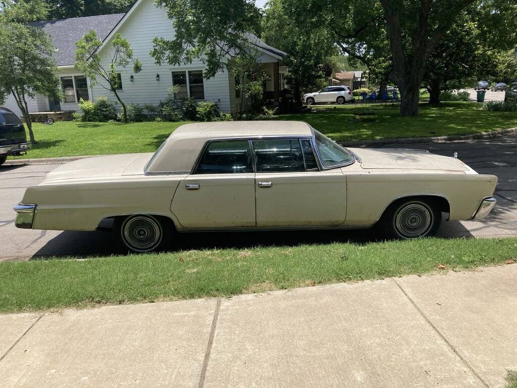

    You got it! Here are a few profile pictures. I think stock height would have front where it is, but rear lower than it is.

    But yes the front does look about right. It is pretty quick and easy to measure front height and check the specs in the service manual. A spacer between the axle and the top of the leafs would lower it, but from the pictures it seems you would need a a pretty thick spacer.
    Make sure your shackles and bushings aren’t artificially holding it up. If you tighten the bushings when the axle is suspended in the air then the bushings may not let the eyes pivot letting the car lower when you set it on the ground. I would try jacking up the rear of the car frame (unibody) loosen your bushing bolts, set it on the ground, jounce the car up and down and then re tighten the bushings when the weight is on the springs and axle. (Don’t loosen when you have weight on the axle in case the bushings are holding the it up)
    And fill the gas tank up and re-evaluate.

    Be patient my friend.
    Drive is around put some miles on it and the springs will settle.
    Your profile pics shows nothing out of the ordinary.
    Load up the family and the Imp will sit level.
