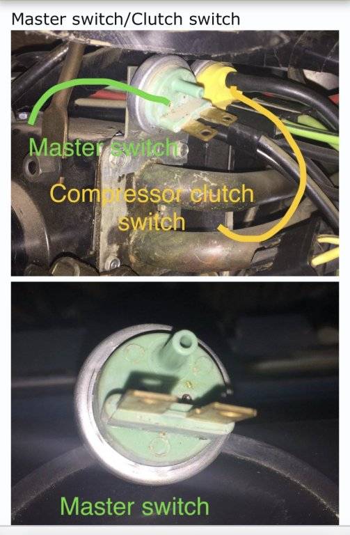

Entering the 9 circles of hell... trying to resurrect my ATC... update IT LIVES!
This master switch was one of the culprits of my non functioning system-but as soon as I replaced it -my blower fan would operate.

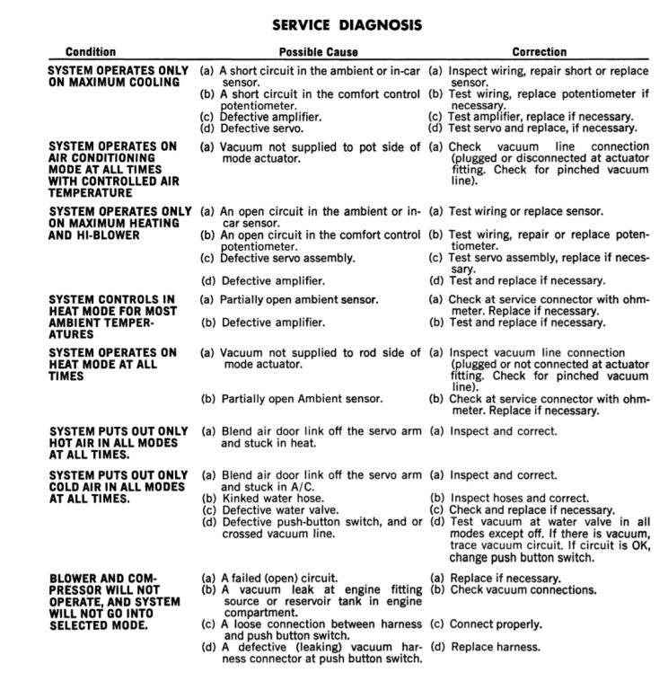

In this case the FSM is your friend. There should be a service diagnosis schematic or list in the "heat and a/c" chapter. Looks like this in mine:
Don't expect it to give you the exact solution but it's a good starting point.
