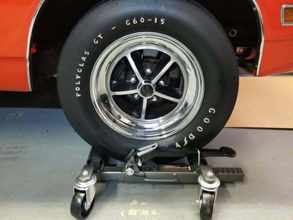

Now using these, also from HF, on the b body.

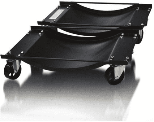

Mine look like this. The downside to these is how high you have to lift the car to get them under the tires, due to the reinforcing bar on the sides.
DO get the ones with the smooth, semi-circular section that the tires sit on! IF you desire to drive the car later, it'll save the tires from taking "a set" to the other styles which put two pressure points on the tire tread . . . even ruining them if inflation pressures might decrease. Might be a good idea to put the tire pressure up to 32psi, for good measure.

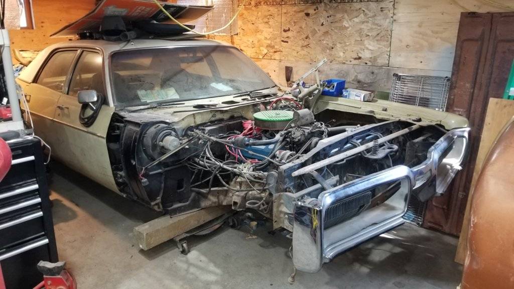

I have the same ones too. I bought mine through horrible freight and i thought they worked well. Sadly i have one of them being held up as i have a 383 resting on it. Works great for that to by the way.
