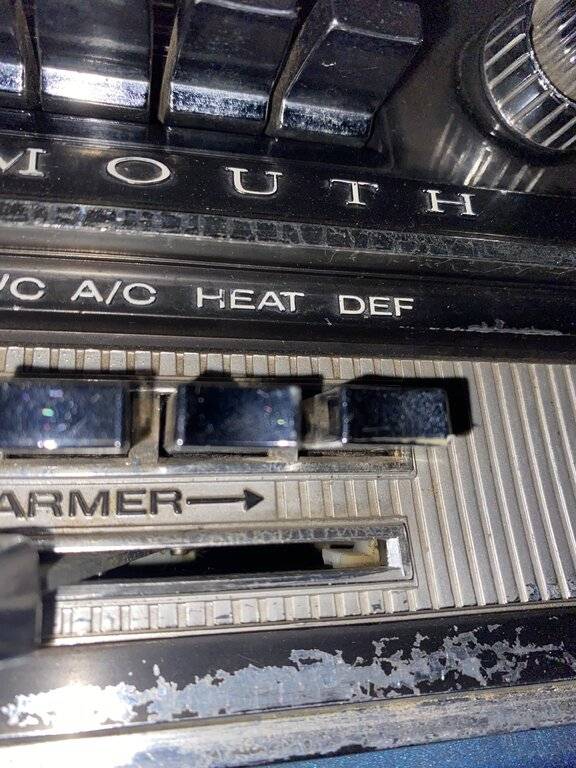

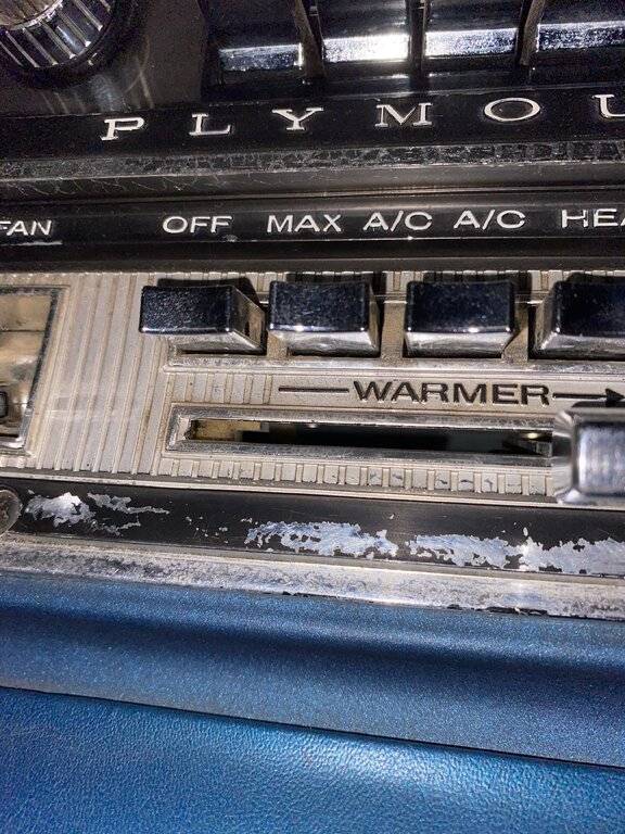

How about the plastic slides in the temperature control unit of a A/C car.
My lower handle flops back and forth without engaging.
68 Fury
68 Fury
The cable on the back of the unit is probably broken or detached. If you are still fairly limber, take a flash light and look under the dash to see if you can see any loose or broken parts as the lever is moved. The cables corroded over time and sometimes the stud on the back of the control that held the cable loop broke off.

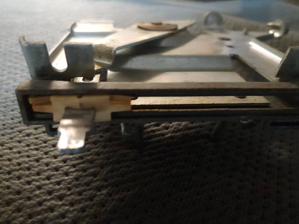

XXCARGUY : As a owner of a 68 Fury with factory a/c i can tell you the problem with the temp slide lever is probably the plastic bushing on the lever that holds the lever in the slide has broken due to age . They break in half so the lever moves freely from cold to hot. i have replaced mine twice. I leave mine set on cool as i rarely use the heat only the A/C .You can manually adjust it under the dash by pulling or pushing the cable where it attaches to the heater unit.Attached is a picture of the slide control the bushing is the white plastic piece attached to the slide lever. I have a friend that i need to ask if he can 3D print me replacement pieces of these.
That’s exactly what I have a problem with.
So where do you get the slides?
...or can you?
I like the 3 D printing idea.
How do they come out? So are the broken pieces usually in the slide or fall into the dash?
Mine broke it his last November.
Can’t find any loose pieces!
I have the original one from my car it is in 2 pieces from when it broke so it came out of the slide when i removed the pin that holds the lever to it . That is the weakest part of the bushing because it is drilled for the pin and that's where it broke. As far how to remove/replace a complete one i don't know i haven't tried. The bushing is not available anywhere that i have been able to find. That's why i mention 3D printing as a option.
