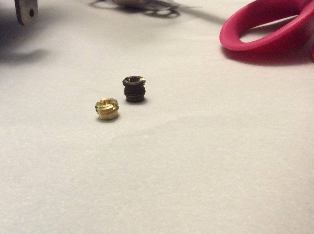

So went ahead and rebuilt the carb b/c I like a project and figured I'd see if it fixed the problem. Figured out the 6125S is a 630cfm carb with 0.089 metering jet primaries and 0.089 secondaries. I boogered up a primary that was stuck and ordered 2 new primaries from mikes carburetor.
The new primaries have a #389 on them and the old primaries have a #489 on them. They are also shorter than the original jets.
My secondary jets match the ones sent by mikes and are the same height and have the #389 stamped on them. Soooo... The question is can I use the new #389 jets for the primaries even though they appear too short?
Pics for reference
I say if the diameter of the hole is the same, it makes no difference but surer than hell some braniac is posting right now that the depth of the hole will cause atomization problems inversely proportional to the outlet side chamfer thus resulting is fuel dispersal patterns to be disrupted requiring....
The only thing I'd worry about would be if the metering rod is long enough to reach the 'neck' in the new jets? I can't tell if the height relative to the floor of the bowl is the same or if the old jet is effectively taller.
The depth of the hole will cause atomization problems inversely proportional to the outlet side chamfer thus resulting is fuel dispersal patterns to be disrupted requiring....
But seriously.... It's been a while since I've had an AVS apart. I think there may be a problem. First, the metering rod and the jet have to match each other. If there is a height difference, the rod may be too far out and cause an over rich condition. Second, I think that jet seats on the top flange. It may not tighten correctly.
This is really a question for the guys that sent you that jet. I'm going from a faded memory and an idea of how it all works. I wouldn't use it until someone smarter than I am about it confirmed it was OK.
