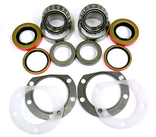

I made this list up a while back since I've replaced my share of bearings. You can often get deals of of ebay for old USA stock. Your car's looking awesome BTW.
8-3/4 axle parts:
2404215 inner oil seal; alternates 2881135, CR/SKF 15460, National/Timkin 8695S, Centric 41763002
2070933 retainer foam gasket; Felpro 13800
2881314 steel retainer gasket; Felpro 55032
3621967 seal package
2525415 wheel bearing set; SKF BR7, Timken SET7

I have Timken #8704S for the outer seal and #8695S for the inner.

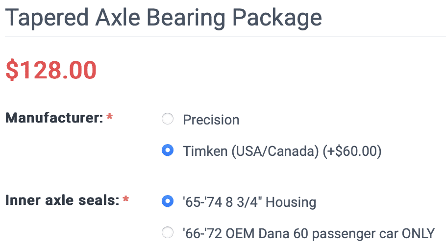

I just ordered the following Tapered Axle Bearing Package from DoctorDiff for Regina, my L-code 1970 Polara 'vert. I chose the Timken (Set 7).
Interestingly, Dr. Diff gives two choices -- Precision and Timken (made in Canada-USA). The price with Timken almost doubles the cost, but that is the one that I ordered on the basis of the info in this thread.
