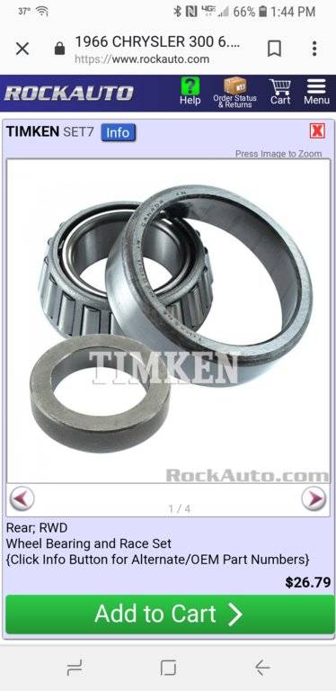

I heard some crazy numbers for these bearing. I got make in USA Timken for $26 and change USD from Rock Auto. No brainer.
Lucky! Rock Auto seems to be the place to go. At the time I was bitching about this to one of my friends who is a car guy (not our kind of car guy, but does his own work) and he had ordered online, a bearing kit for his five year old lexus that just happened to show up that day. They were Timkens! I couldn't believe it.
