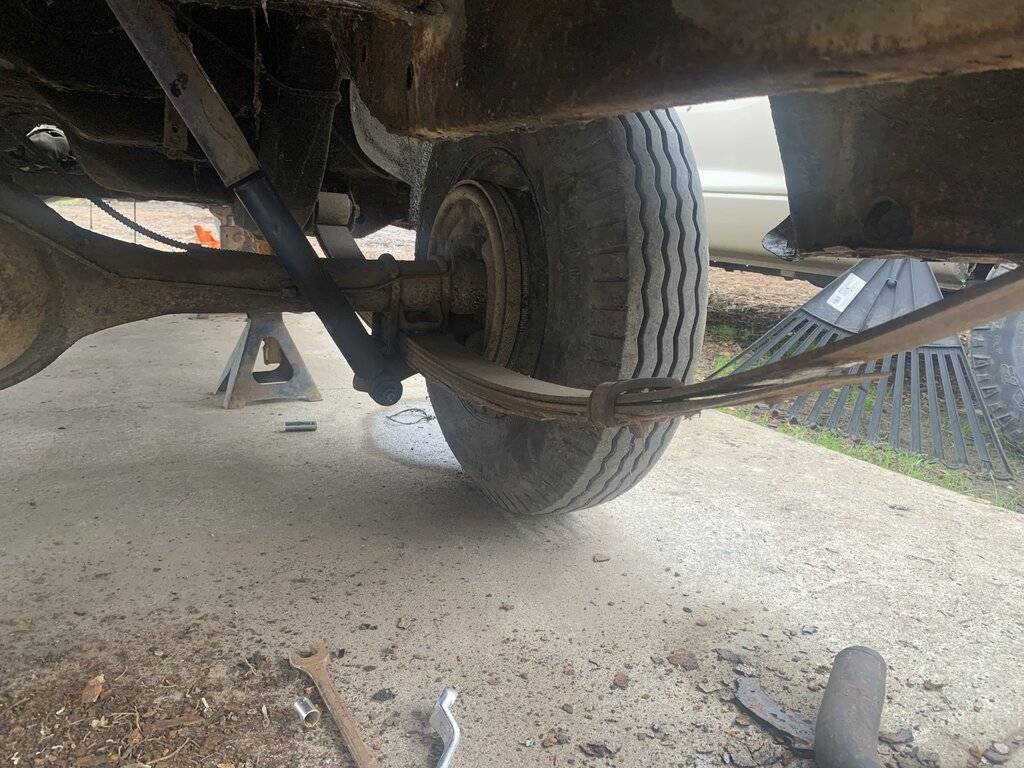

Hi all, new here with my first ever C-body.
I recently purchased a 67 Fury III wagon. It has new leafsprings but it looks like a previous owner wanted to lower the car. I want to use it to haul and tow. It has air shocks in it now but I had to fill them all the way just to get an even ride height. I have leaf springs in my 65 Belvedere wagon that I had rebuilt and re-arched. Would I be able to swap them? Are the measurements the same? Since both cars had them done recently, it would be easy to swap out since the hardware isn't all rusted out. It's all new on both wagons.

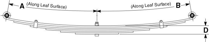

This page has some dimensions listed:
Mopar Performance Leaf Springs | General Spring
Dimension A is critical to ensure the rear axle will locate properly vs the wheelbase.
Dimension B ensures the rear shackle will swing properly.
Years ago, out of necessity, I installed 22x35 springs from a Cordoba in a 65 Fury, which is to have 22x36.
When I jack the car up by the frame the relaxation in the spring causes the shackle to swing forward and pop up to the trunk floor. So I must remember to chain the shackle rearward beforehand. (a longer shackle might solve this, but that's generally a piss-poor addition to a leafspring setup)
If I forget and the shackle pops, it's a royal PITA with crowbars and slowly lowering the car with the jack to get it to reset, it's a 3-handed job.
