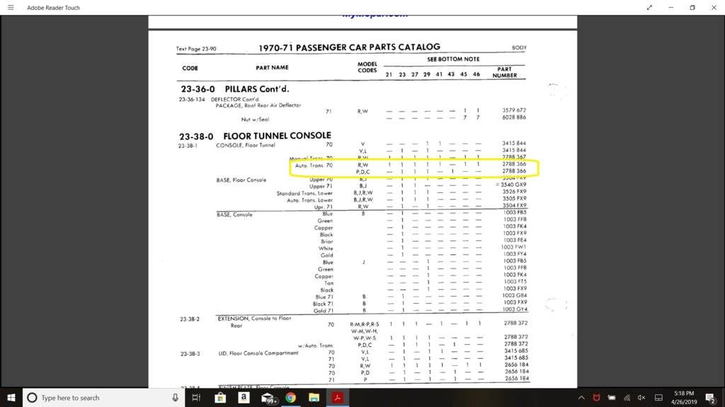

C Body and B Body Consoles are not the same in 1970 and above.

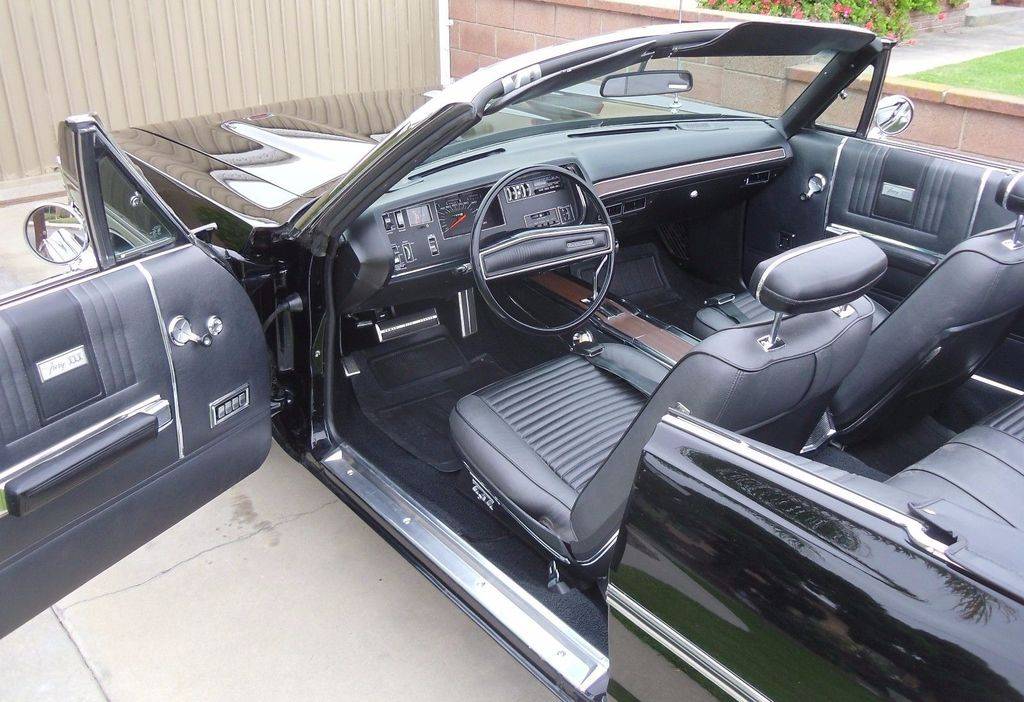

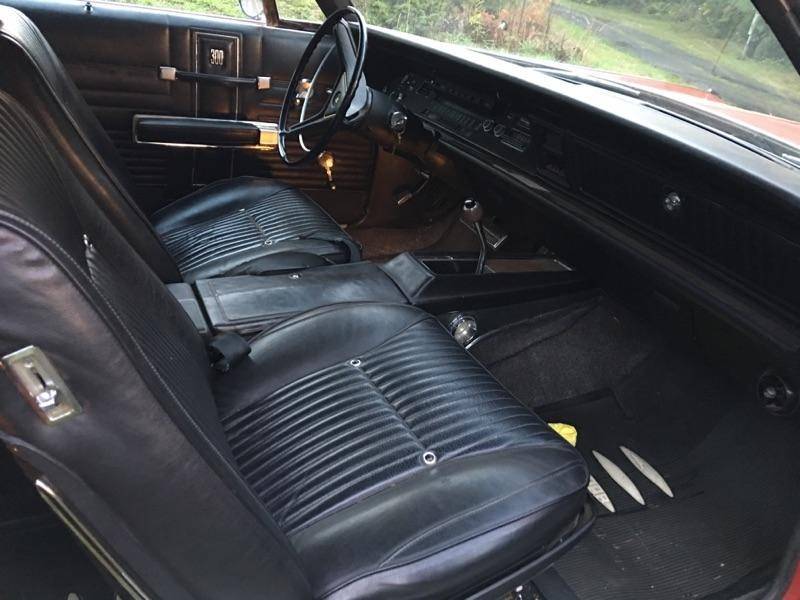

I am certain that Dodge AND Chrysler used the padded top consoles. Plymouth used the same as the b body through 72.I also think that Fury and Polara/Monaco consoles were almost identical to those used on B-Bodies while only 1970-up Chryslers had their unique consoles. But that's judging from pictures only.
1970 Fury:
1970 Chrysler:
