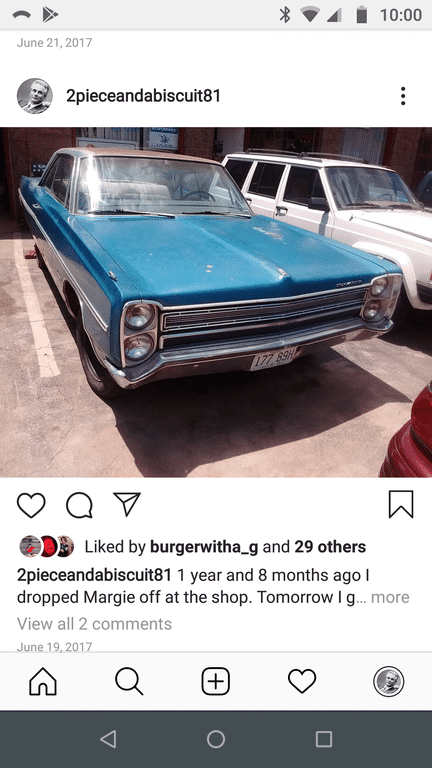

Here is one of the more recent pics of Margie in front of the shop she lived at for 3+ years

Really sweet. Love the color
Would like too see more. I’m in Mascoutah brt
Thanks, is it an original 440 car?
