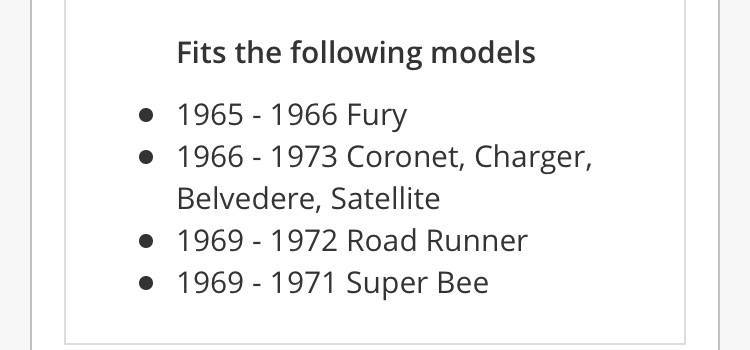

Followed the link from commando1 and found this. Part number 78-551. Looks like b body is the same as 65/66 fury

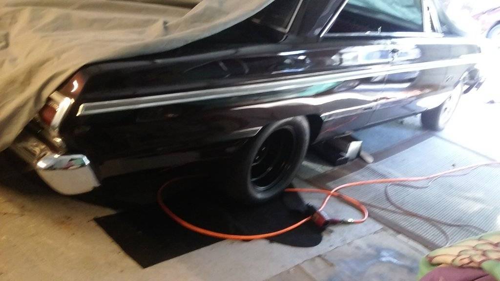

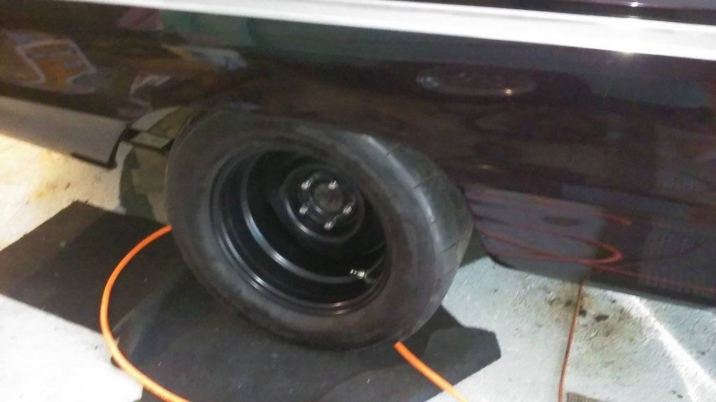

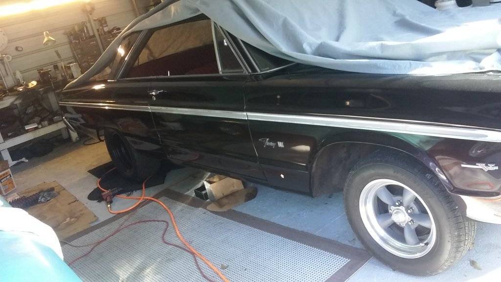

OP, here are a couple pics of how the XHD springs set my car up. They may sag some, for reference those are 26" tall tires.I also have some longer than stock shackles.
I compared my 65 sport fury leaves with a set from my brother's 68 road runner and they were exactly the same. So I bought a set of the B body XHD springs and put them on my 65 Fury. They have been on the car since 1984. Perfect fit.

In looking at your web pics, looks like your ride height is same as mine. Do you have stock shackles?
PS your car has always been inspiring in my build. I've looked at it countless times for ideas.
