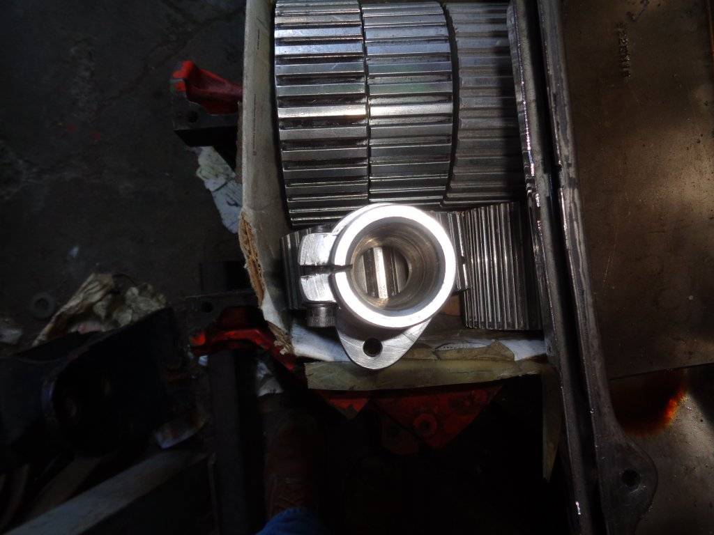

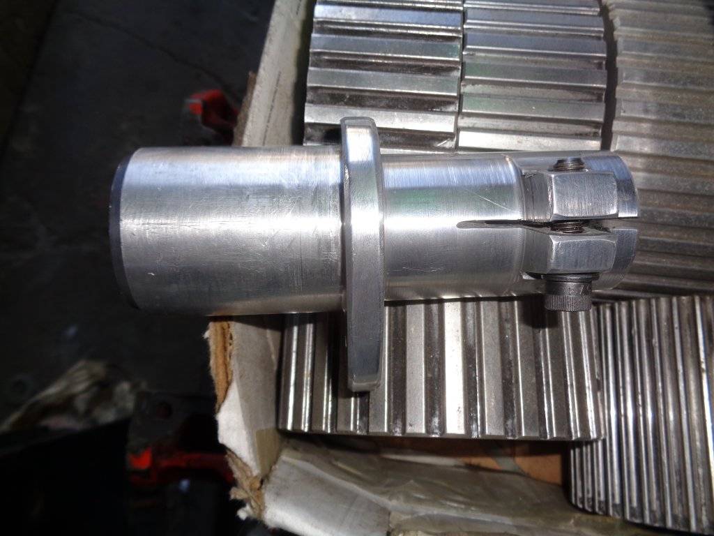

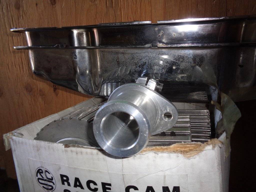

san jose california
condenser will take a sh..t for no reason . get a couple extra or change out that points type dizzy for a electric type . i'm involved in building an adapter for the early hemi/poly headed motors to use the other guy (chevy) dizzy in those motors . but not retailing these yet . i designed it for magneto ignition use in my early hemi's 301 331 354 392 , it clamps the body of the ignition dizzy way better than the forks could ever do .
