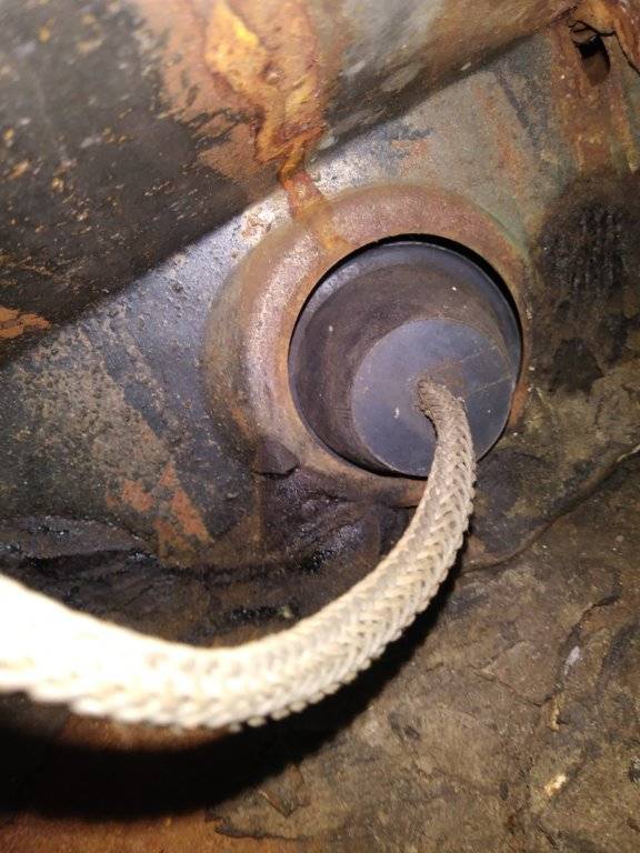

I have two...one on each side and both are so old they shrank enough to fall through the body hole and wont stay in. This leads right to outside. My taillight wires run through them to cross over to the right side.
Snap a picture when looking at it. It will help us visualize and come up with an alternative or if is used somewhere else.

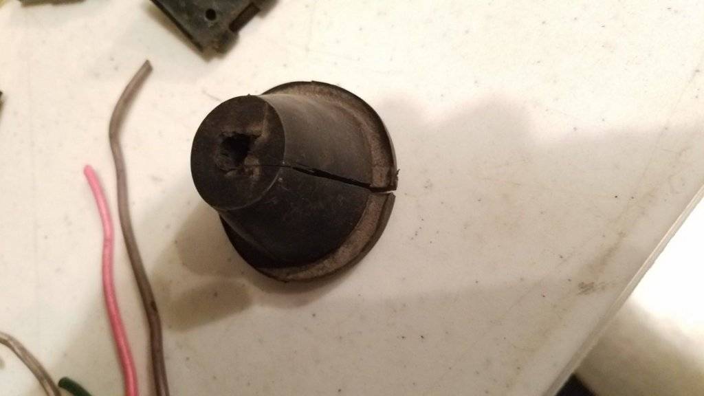

They're a smaller version of the big cone-shaped grommet (I think of them as a plug) that the power window wires come through in the firewalls of our Cs when exiting the dash. Very thick robust rubber, with the wires encapsulated in the grommet. To service the wires within the grommet one has to slice the grommet, which kinda defeats the purpose of the grommet. They look like this (B body PW harness body grommet stolen from an eBay ad), and you can see it was sliced.
Wow yes that would be difficult to attach a new one without cutting or without taking all the connectors off and threading through.

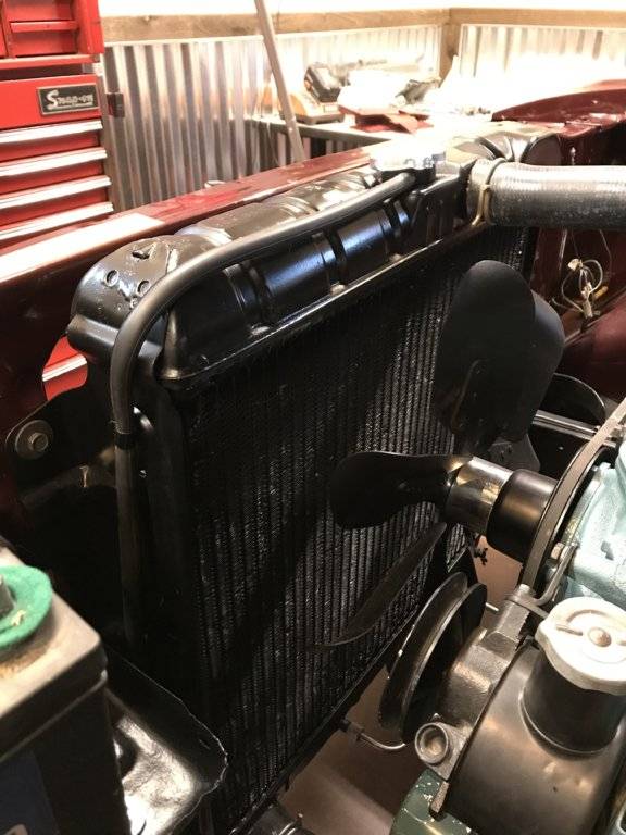

The actual grommet looks to be in shape. What is bothering reasoning for replacing? If it is because you are redoing or changing the wires in the harness then re thread it before putting the ends back on. If you just want to clean it up I found the best is almost straight ammonia which is supposed to soften the rubber back up. And then to make it look like new. Spray it with Eastwood PRE. (Wax and grease remover) and really wipe it down. It makes it look like new.
Here is a picture of my 50 year old original radiator overflow hose. It looks new.
Its 50 yrs old....Its supposed to seal the hole that it's sitting in...it falls right through it...that's why I want to replace it.
I'm lost here, so what's the issue? It falls through the hole, OK fine. You'll have to track that wire back towards the front as I'm sure there's a connector from the front harness to the rear. Probably under the carpet. I bet ya dollars to donuts the hole in that grommet would fit over that connection. Good Luck
Having renewed several wiring harnesses recently, I can tell you that the wires are very very difficult to thread back through those grommets, by design. Not only are they supposed to seal to the opening in the body, but to the wire and whatever sheathing they have as well. Even if a suitable replacement was found, one would likely be wrecking the very brittle webbing-wrap that is shown in his photo getting the old one off, as the grommet goes right over it. Ditto for any other wrap on the wires.
If I were in your situation, I would see if I could use some sort of adhesive sealant to hold the grommets in place.
