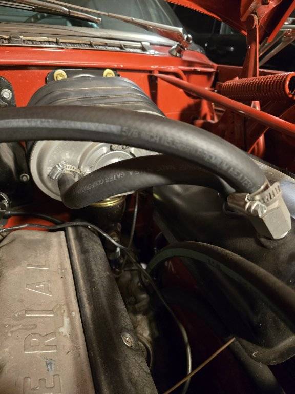

Well, unfortunately, the last person used heater hose instead of vacuum hose, so it's not correct to begin with.
Thanks, John. Here is what it looks like now:

That 5/8" hose is a bunch larger than the 11/32", so I'm wondering if some one has changed the fittings. Usually you see 3/8" hose (.375" dia.) used in its place. 5/8=.625 and 11/32= .343"

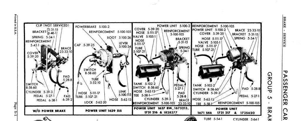

Here's a couple screen shots from the parts manual. Get a copy at https://mymopar.com/?pid=31

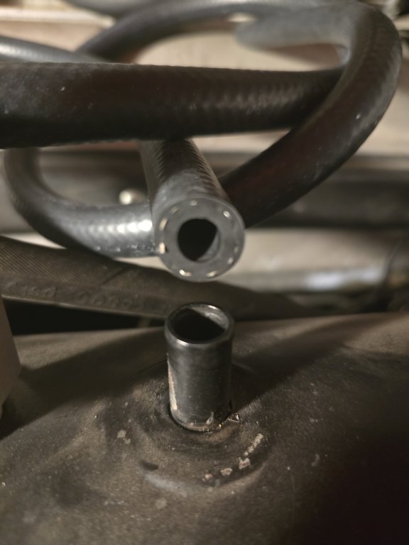

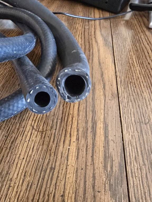

Well, I got the new hose today. However, I have a hard time believing that this 11/32" hose is correct for this. I tried to get it on the fitting, but it is just too small to fit. This new hose I have is clearly marked as 11/32". I've shown pictures of the 5/8" heater hose that was on there, compared to the new 11/32" hose, and one can see the difference. I also have a photo showing what the new 11/32" hose looks like compared to the fitting.

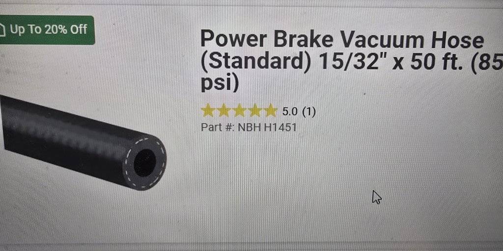

I'm thinking what I really need is this 15/32" hose, even though the parts book says otherwise. Any concerns or observations:

15/32 = .468". 5/8 = .625" The difference is 5/32" or .156"
So, I don't think that will work. The thing to do is measure your fittings.

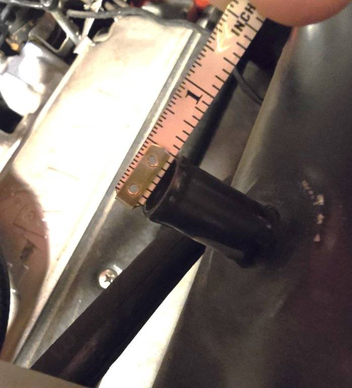

The hose fitting is right around 1/2", give or take 1/32":
You need to buy a set of calipers. Harbor Freight has some cheap, toss in the toolbox versions for a couple bucks. Better yet, spend about $25 on their 6" digital caliper.
Anyway... 1/2" = .500". That 15/32" (.468") should fit.
