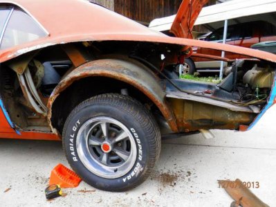

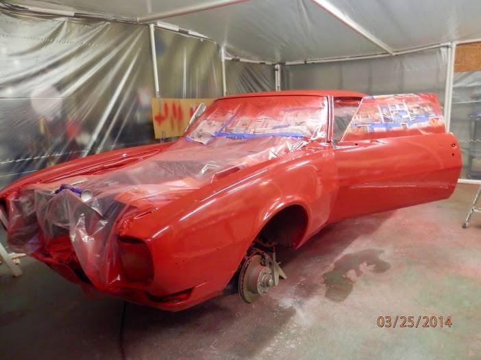

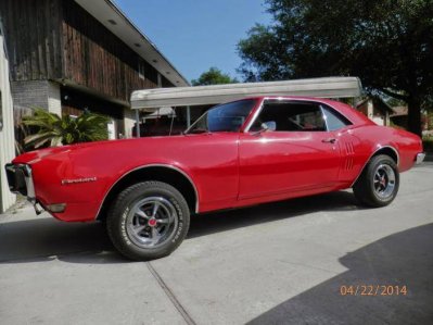

I agree with the BC/CC guys. Very forgiving. I did my 1st paint job last April, '68 Firebird after extensive body work. I jumped right in, bought plasma cutter, HF Mig and painted in my shop. Came out very nice from all accounts. Talk to your local auto paint dealer and a lot of good info on YouTube. Sold it to buy the Fury which is getting close to paint itself. Just finished up engine bay last night.
