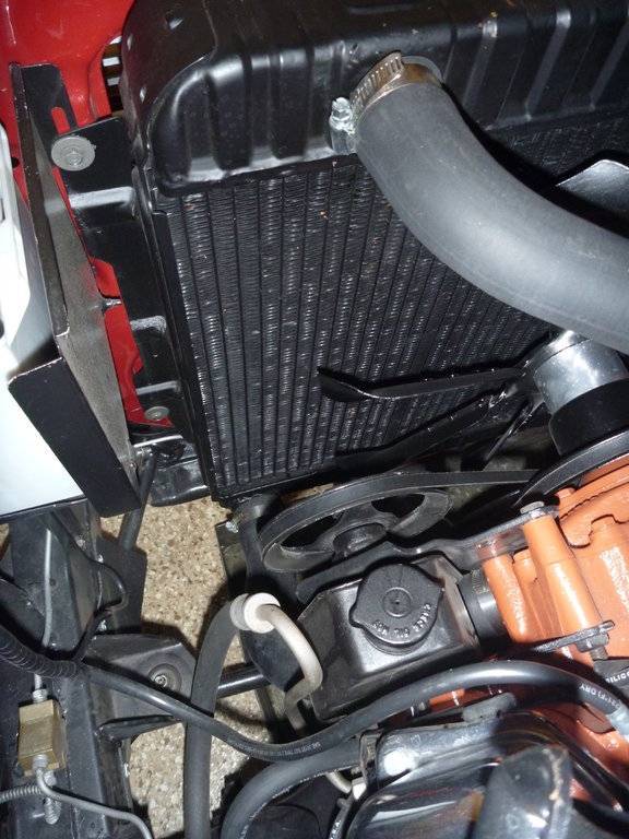

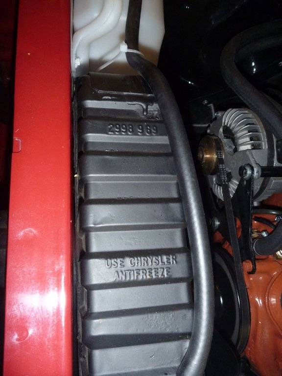

I decided to really look at what I have for a rad. According to the parts list I should have a 2998 969 which was the only 22" rad used for a 70 Ply/Dodge/Chry 440 without AC.
Next, my in/out plumbing is all on the driver side.

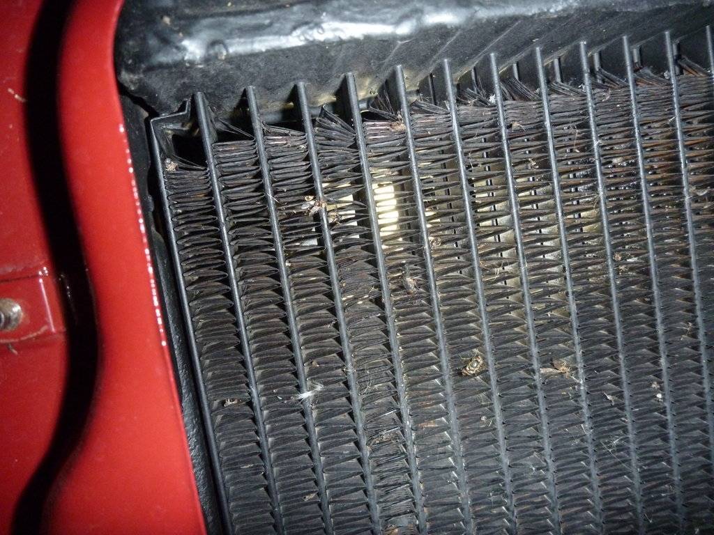

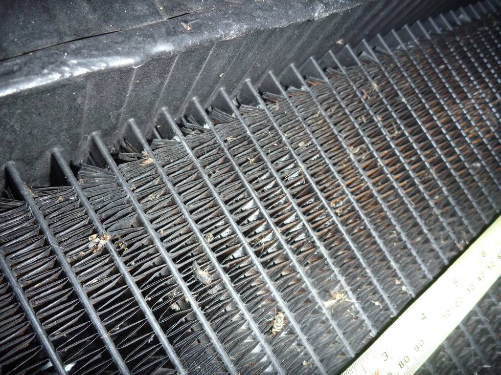

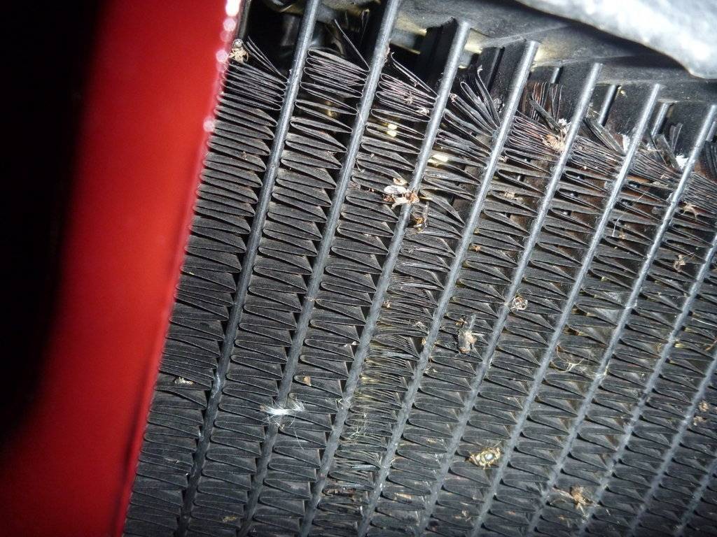

For those giving me a hard time for not driving enough, I have a bug collection that proves otherwise. I measured the thickness to 1.25" and the vertical flat tubes are spaced about 1/2" apart. However I'm not liking the workmanship. I would think the fins would be soldered at both sides to adjacent tubes. It looks like this not always the case. If half weren't soldered then that would reduce the rad efficiency by 50%.
I think that pretty well tells the story, crappy rebuild. Hopefully Graham's Red Deer guy does better work.
