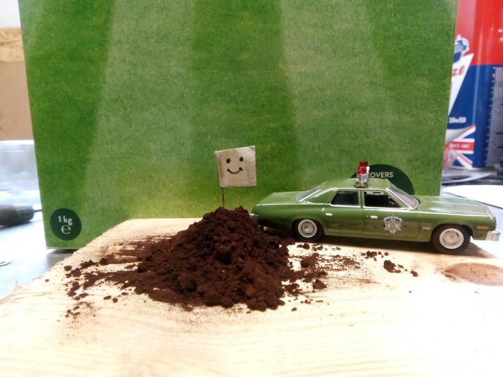

Where did all of the gunk come from? How long had the car been setting before all of this happened?

As you can see it was quite a bit! We've not had the car long and it's never given any problems, took the top off the carb and stood back, the floats were resting on the crud. Lot smoother now just have to sort out the starting

thanks for all your help, car is now starting much better and running beautifully , just needs a little fine tuning and some learning on my part.. I sold the residue to the local fracking outfit..
