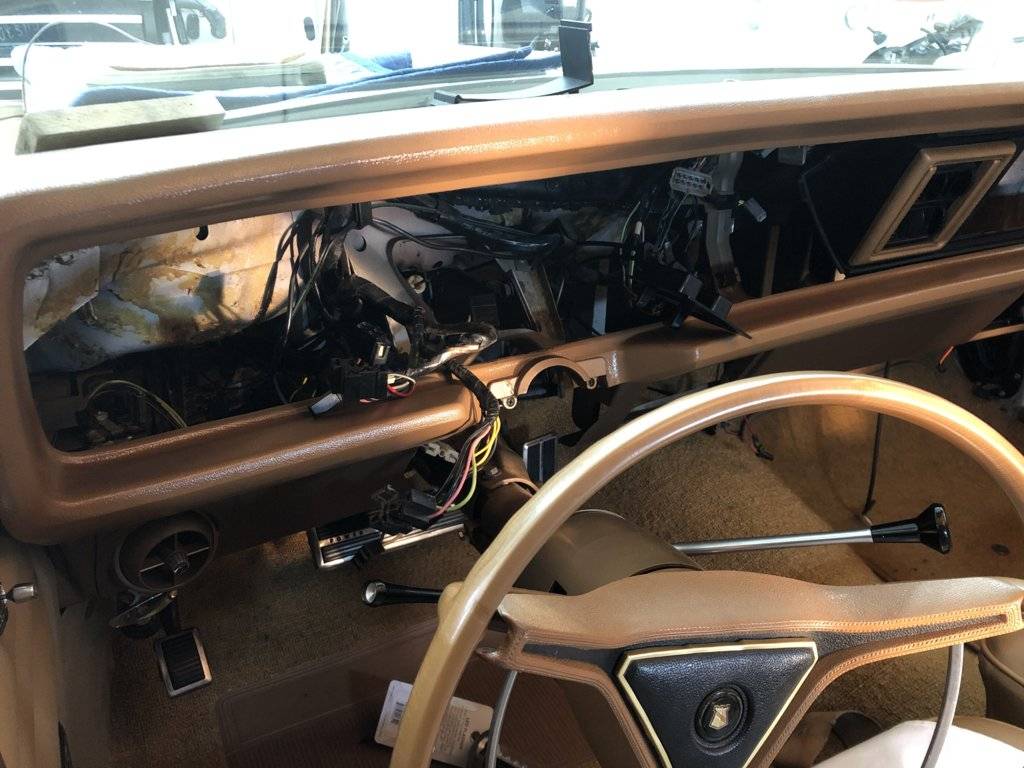

...because when you do, you can (unintentionally and unknowable-y) shift the car out of Park. When the column is lowered, this can also move the torque shaft, and now the car can roll away!
I noticed this when I recently dropped the column to pull the IP. No disaster in this case due to my level garage , but after a day or two of getting in and out of the car working the IP, AC box, etc, I realized the car had moved rearward about 8 inches.
Chock your wheel!!

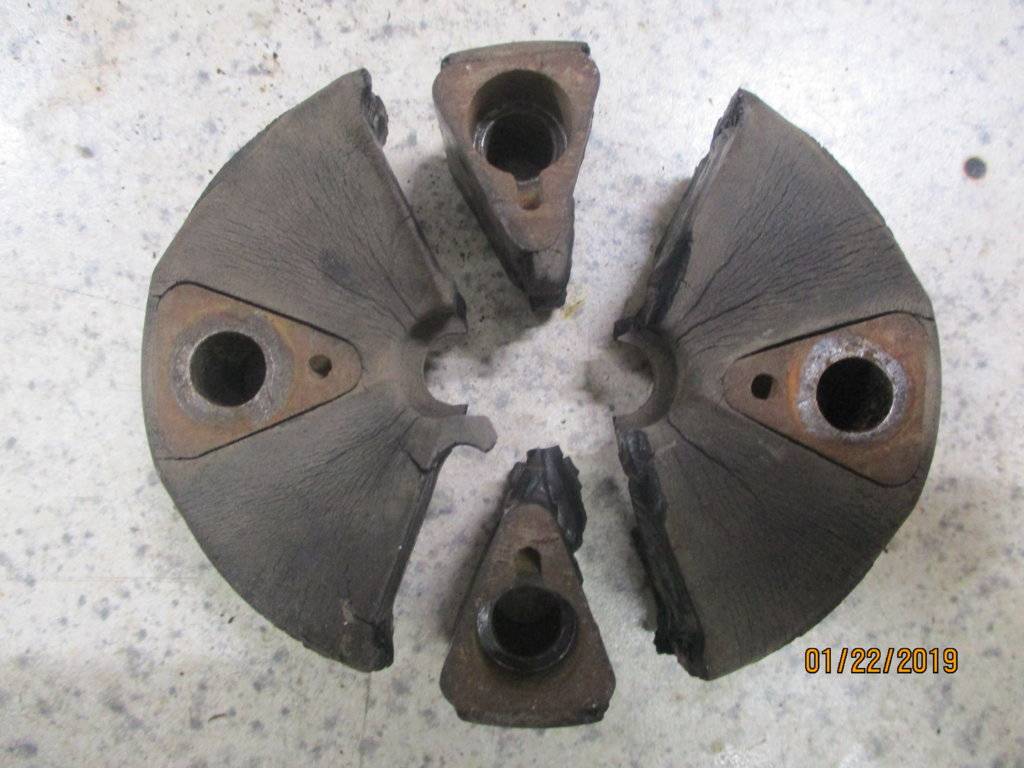

As well, you should not lower it so far as to pit undue strain on the rubber rag joint, as it can crack and tear. Those joints are getting harder to find and can be expensive.
Put a box or something on the seat to hold the steering wheel up a bit.
Good point, but in my case I have the Bouchillion aluminum biscuit thingy. If you have a 50 year old Mopar, that joint that's an inch away from the Furnace-Of-Hell exhaust manifold is already faaaarrrrr beyond Cracked and Torn.
