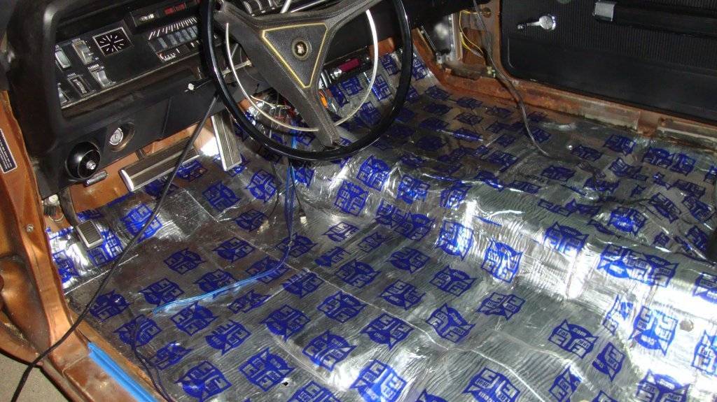

So this is what I've been busy with the past few days...
finally finished tonight..
What a job that was
I ordered 80sq ft of the GT-Mat product 80ml.
Seems like good stuff
I just have to finish sealing off the joints

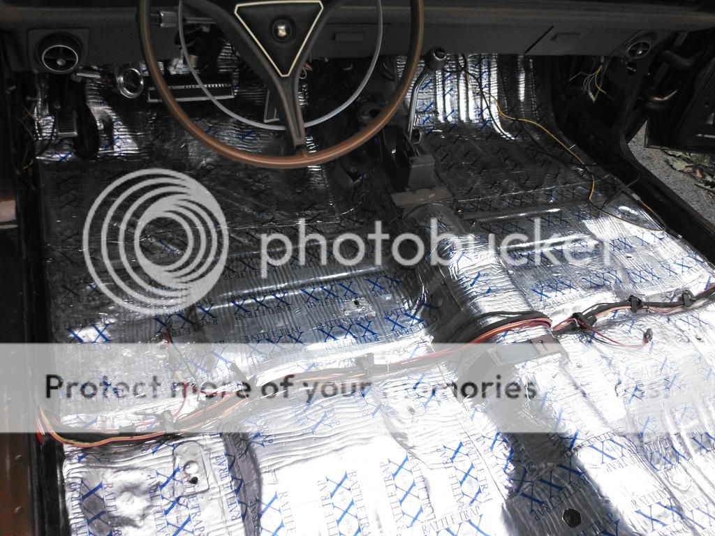

I put something similar down on the floor of my 300 vert. I think it's Fat Mat or something like that. The car is a lot quieter and it was worth the effort. I did the inside of the doors too.

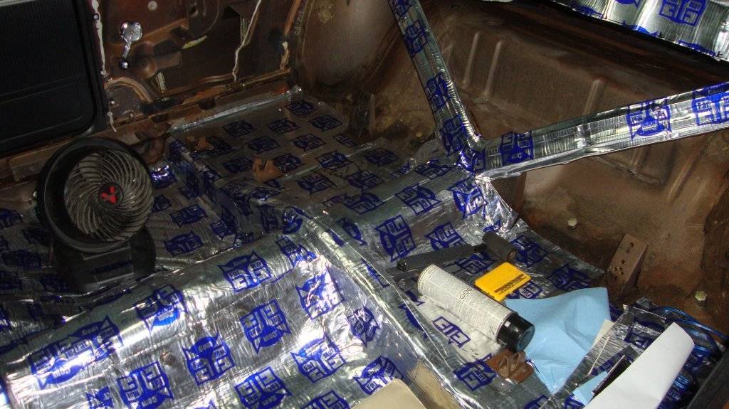

I just finished putting fat mat in the Newport and also used a "j roller" to work the material into the nooks and crannies. if it's hot enough outside, it goes on pretty easily.
