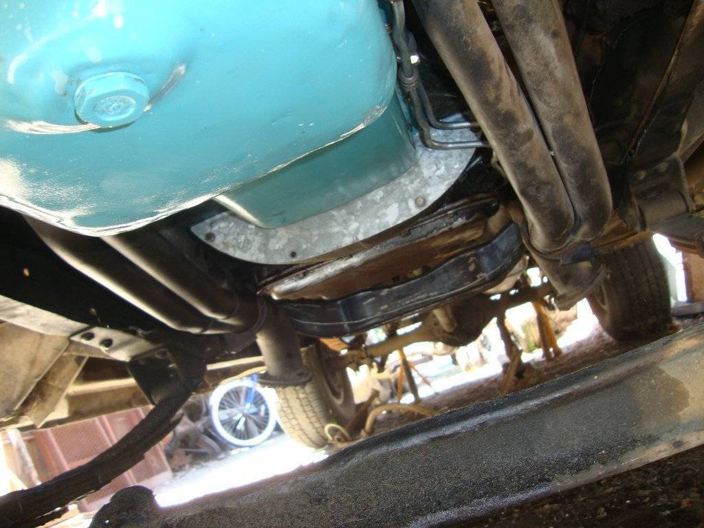

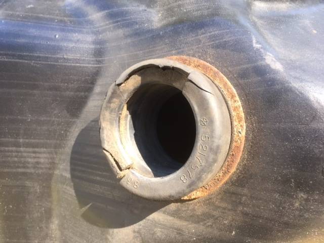

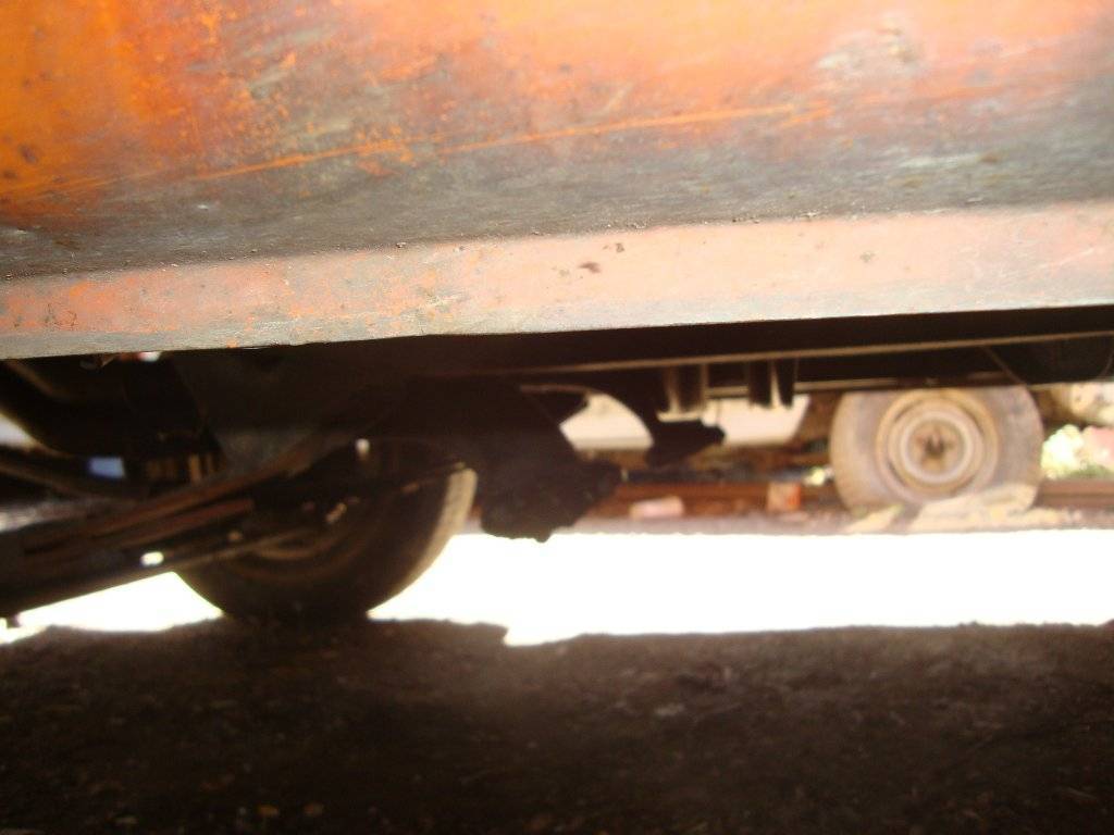

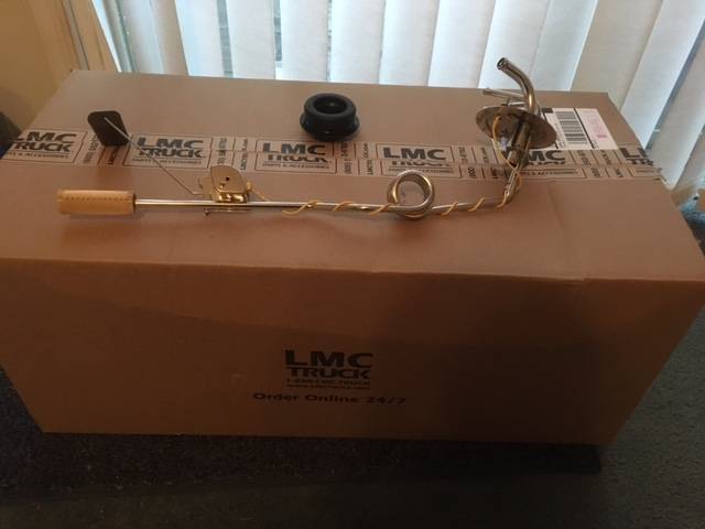

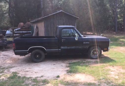

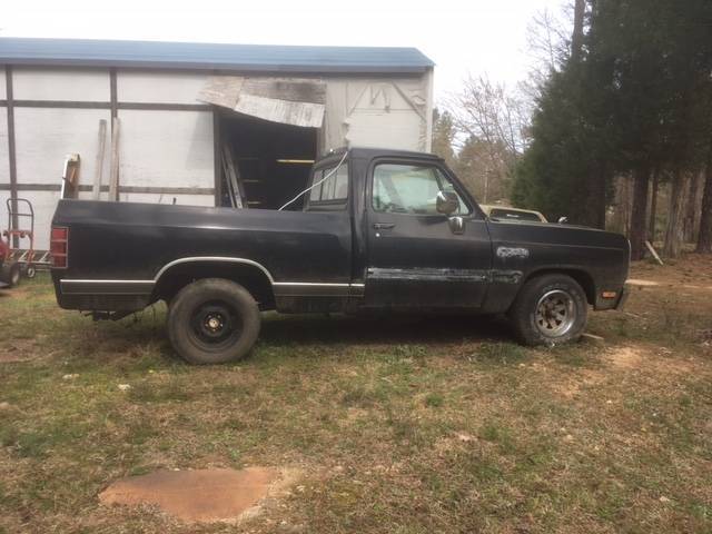

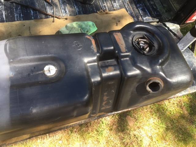

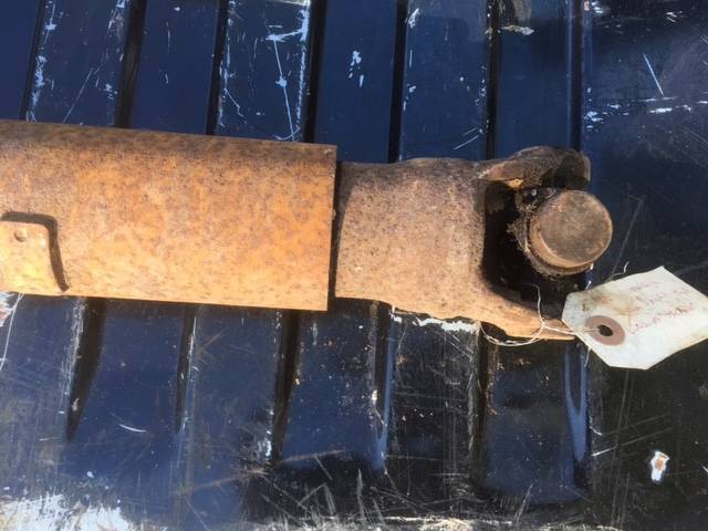

I got the bed back on. Had some 3/8 alunimum fuel line left over from another project. I got that mocked up. Finished up the suspension drop. Looks like I ended up with 2 1/2 Was hoping for at least 3 inches. I bought a new fuel sending unit & fuel tank grommet from LMC Truck parts. WANTED a 3/8 line but all I could find was a 5/16. I found a driveshaft in my stash that looks like it will fit just so I can drive it around & work out bugs. I'll order a new driveshaft once I'm ready to get on it harder. So I hope to get the fuel tank in this weekend. A bit concerned about the vent line. I wanted to install a driveshaft safety loop but it's tight under there so I think I can take it off the frame on the pass side. Will require some mocking. It's comming right along. Hopefully I can have it driving in a week or two

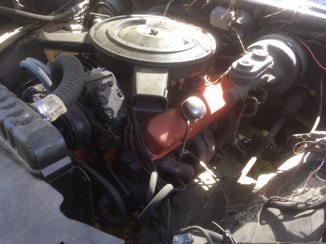

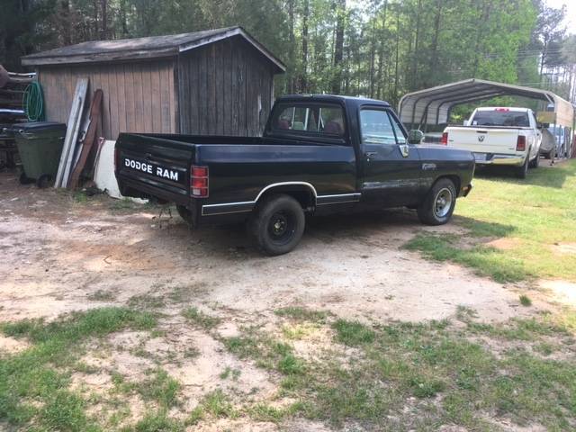

Finally, finally, finally got project D440 moving under its own power. Got the fuel sender from LMC truck installed. Had to reinstall the old drive shaft. The one from my stash that is the correct size has a frozen U joint. I need to buy a new drive shaft anyway. I was so excited at how good it was running. I jumped in & started driving around the yard. I hit the brakes & that's when I remembered I had not finished the brakes yet. WHEW it's all good. Didn't hit anything. Pull in the driveway & gave her the first bath she has has in years. The engine sounds great & the truck sits better with the lowering kit. Next finish up the brakes & order a new drive shaft. Then fab a safety loop.

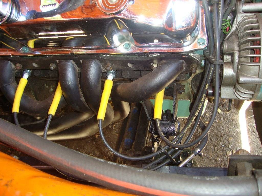

Damn I wish you where my neighbor. I have headers & turbo muffs right off the collector for now. Sounds awesome

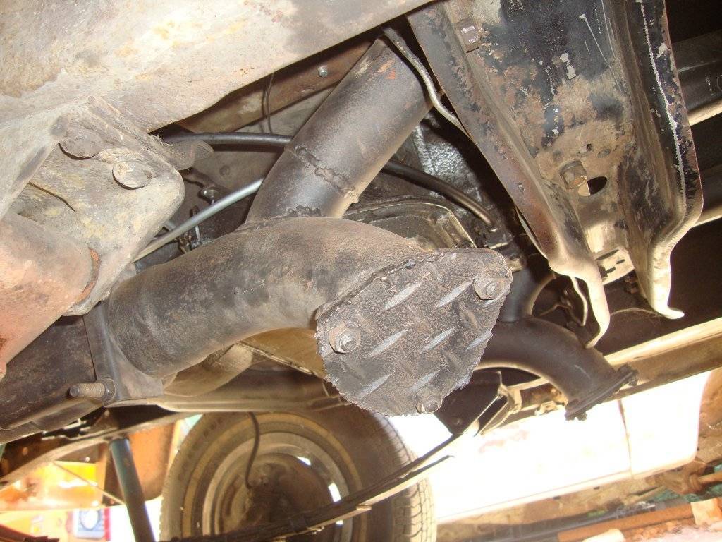

i ran the exhaust back behind the cab , into turbo's myself . ready for tail pipes , can copy my stock ones , got a drivers side from the /6 and a passanger side from the 69 crewcab 318 p/u , but not for long . got a great motor/trans a 440/727 from a 70 nyr and a 440 from my 75 ramcharger only had 60k on it . peeled it from parts for my 72 w200 crewcab i've got a h/m 413 ind with loadflite behind it .
