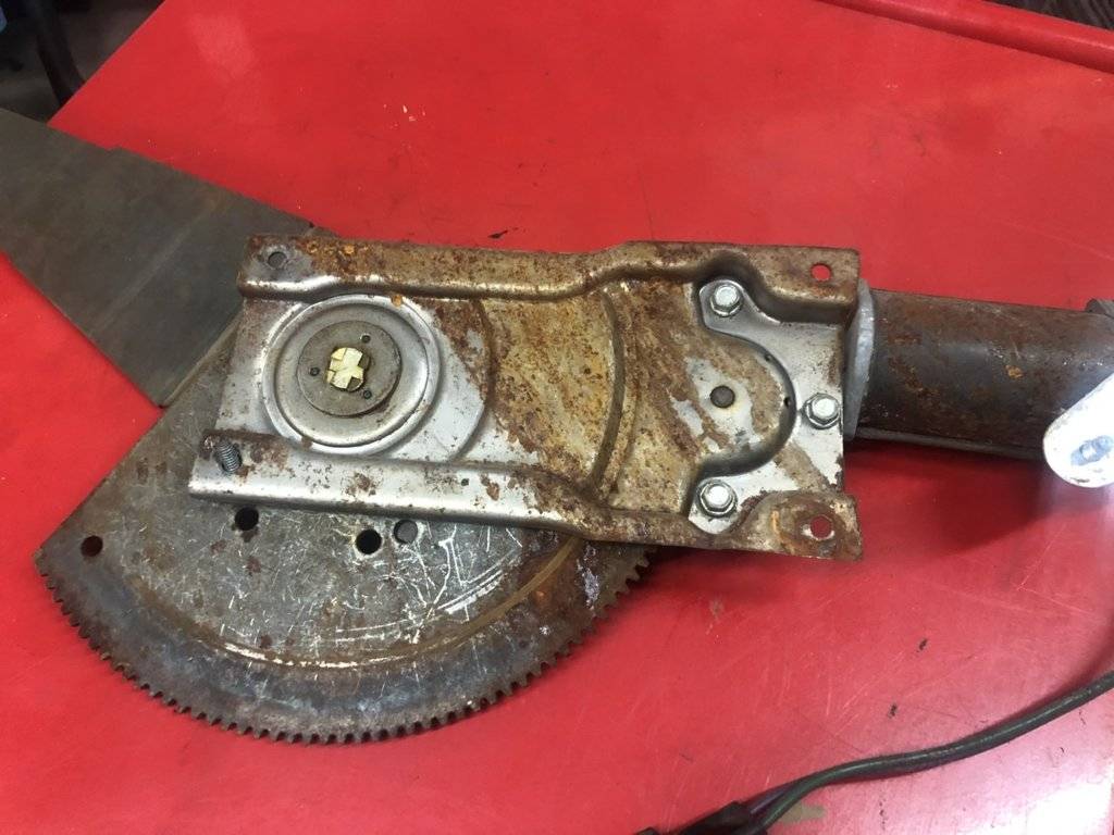

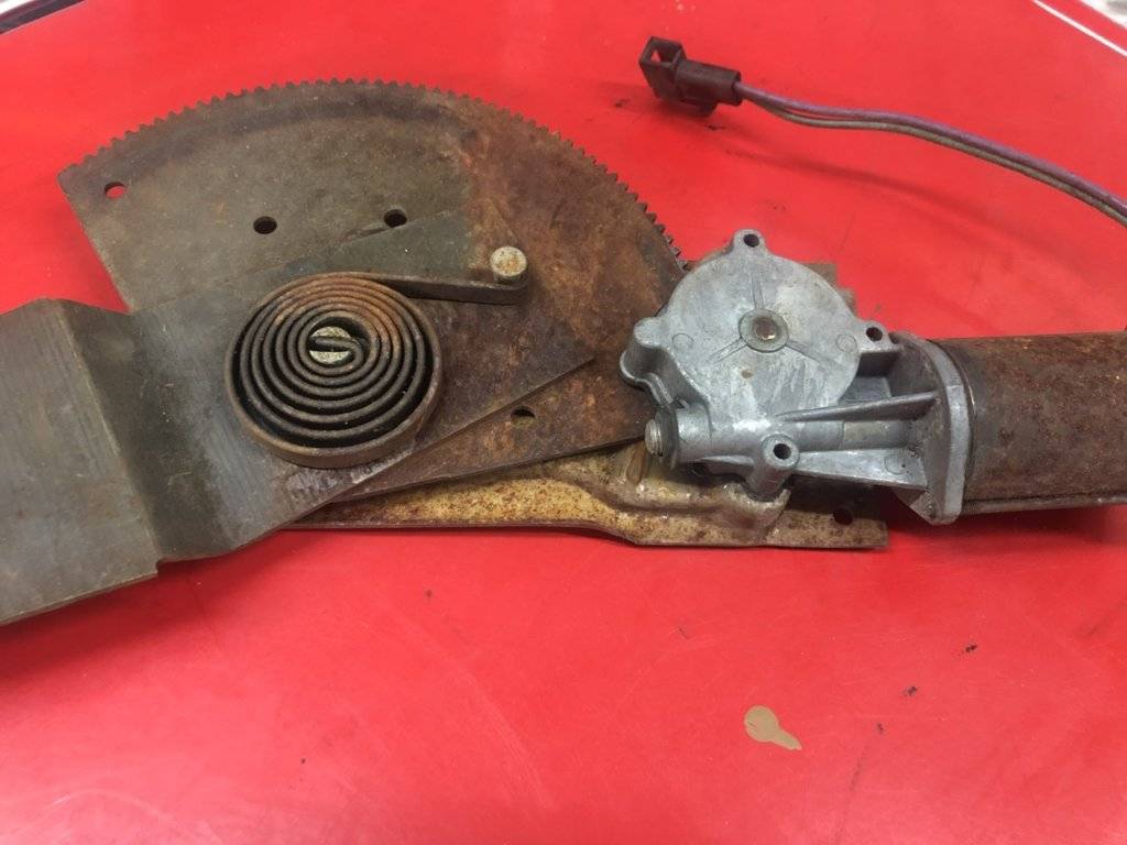

... I’m sure someone knows what to do here! I understand the spring with unwind if I simply remove the motor. How do I need to secure that spring or the components it is holding...

Or just take a pair of vise grips’s and clamp the thing with the teeth on it to the thing that the motor is bolted to.
Stick some screwdrivers or a bolt with a nut through the holes so that it can't unwind. Let the spring load the regulator arm up against the bolt to hold it in place.

The simple answer is to drill a hole through both arms of regulator and use a bolt and nut to secure it. This is a very dangerous spring and if it does comes apart it is very difficult to restoring the spring back in place.
I used the bolt method on my 70 worked excellent. If I was really smart I would have used the bolt method while still in the door rather than fishing it out then trying to install it afterwards.....:BangHead::BangHead::BangHead:
BTW you drill a hole through the door panel and the regulator together then install bolt and voila no broken limbs!

now, for someone who has had them apart, if the gear is stripped now and I could move the window up and down, manually, what is stopping the spring from unwinding now with the regulated unbolted from the door frame? Isn’t the motor and gear what is holding it locked in place right now?
I’m probably going on a 7 or 8 motor replacements on my silver car and just did 4 on the green coupe earlier this year. I no longer pull the regulator out of the door when I do it and never have had a locking plier fail on me. Come to think of it as a metal fabricator in some of my work and restoration projects I can’t remember EVER bumping a locking plier loose that took any effort to squeeze shut.
There’s a familiar site. The motor that is.

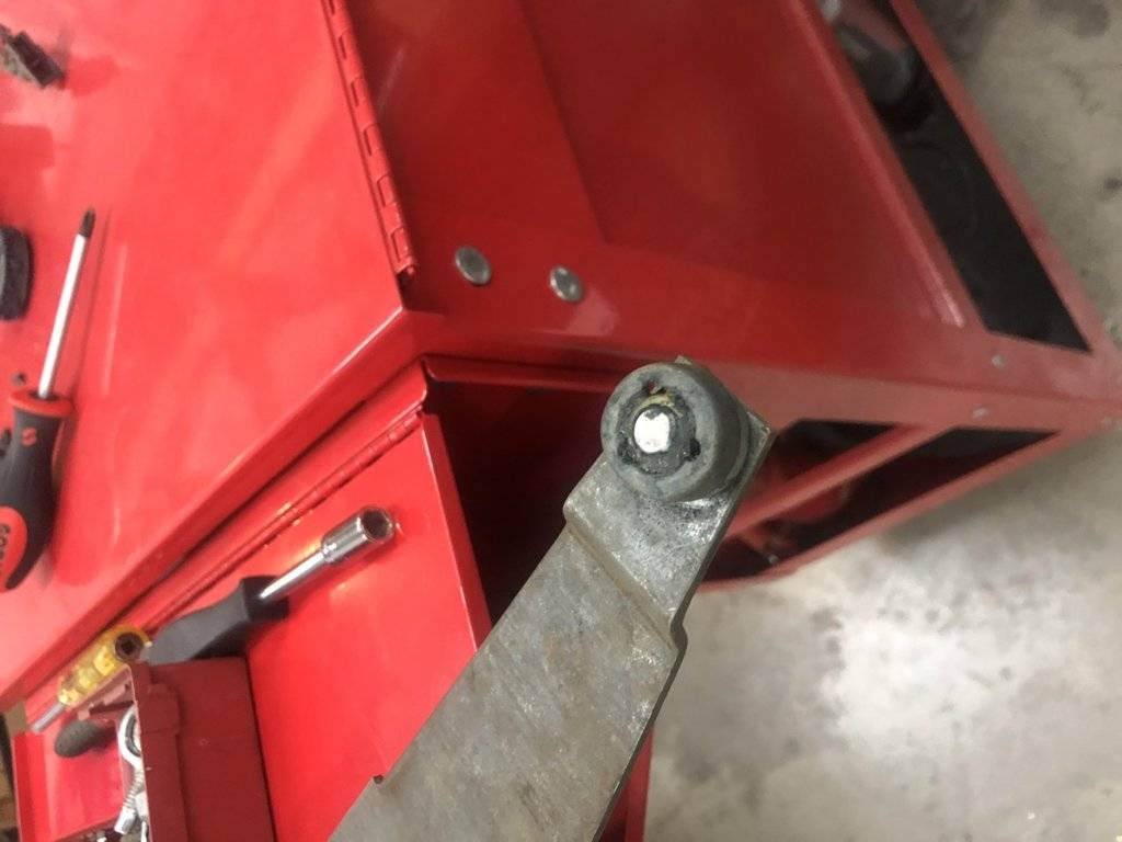

As far as that roller goes it doesn’t look anything like the ‘60s stuff I have here.
For future endeavors, make note of where the 3 bolts that hold the motor to the regulator are and drill a 3/8" hole through the inner steel door panel so you can get at them with a 1/4 drive socket. As long as the regulator is still connected to the glass and bolted to the door, you can reach in and hold the motor and spin out the bolts and remove it safely in just a few minutes. Very low risk of bloodshed and no wrestling with that long handled regulator trying to figure out how to hold your face so it comes out through the hole in the door.
Kevin
Window up, quick grip clamp on the glass at the door beltline, remove all but the forward most fastener holding the reg to the door, loosen by a couple of turns the last one and install locking plier where I mentioned above. At this point you can get at 2 of 3 fasteners holding the motor to reg, remove the last bolt holding the reg to the door and Move it far enough to access the last bolt holding the motor to the reg through the same hole used to get the other 2 out. Grab the new motor and reverse the process. Make sure you clean any old grease out from around all the moving parts and squirt some new in. In the rear of my coupe it takes longer to get at the motors than it does to actually R & R them and I’ve got the doors down to 30 or 40 minutes per.
