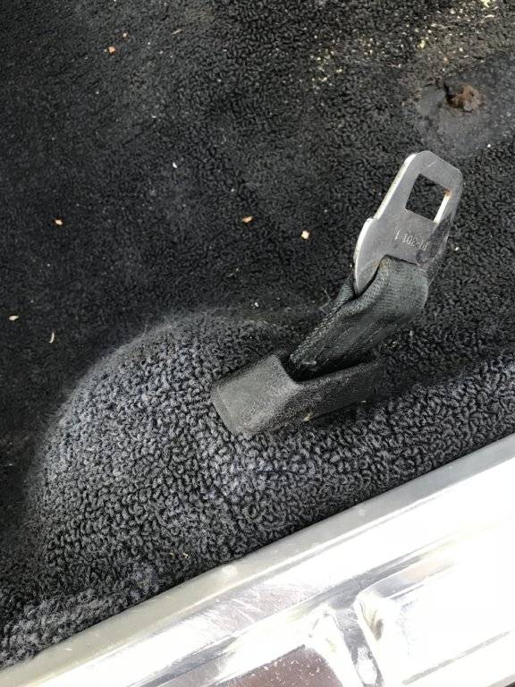

I'm replacing the carpet in my car and before I go all Cro-Magnun on it, I was wondering if you fellas have a tip for removing the plastic cover that attaches to the seat belt retractor that's anchored to the floor.

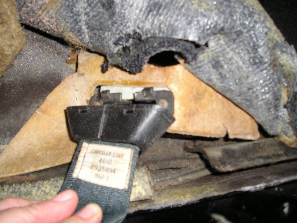

Pete, IIRC (it's been 2 years since I removed my carpet) you basically unsnap that cover (put a little bit of inward pressure on the long ends) pop it up, and then push the buckle + cover through the carpet. I know I have pics of it sans carpet somewhere. Ill check when I get home this afternoon.

1969 300
Okay, mystery solved.
The cover is hinged and there are two tabs you push to release it. It does not cover the cut edge of the carpet by much so you might want to trim it out before you crack open the Yuenglings.
