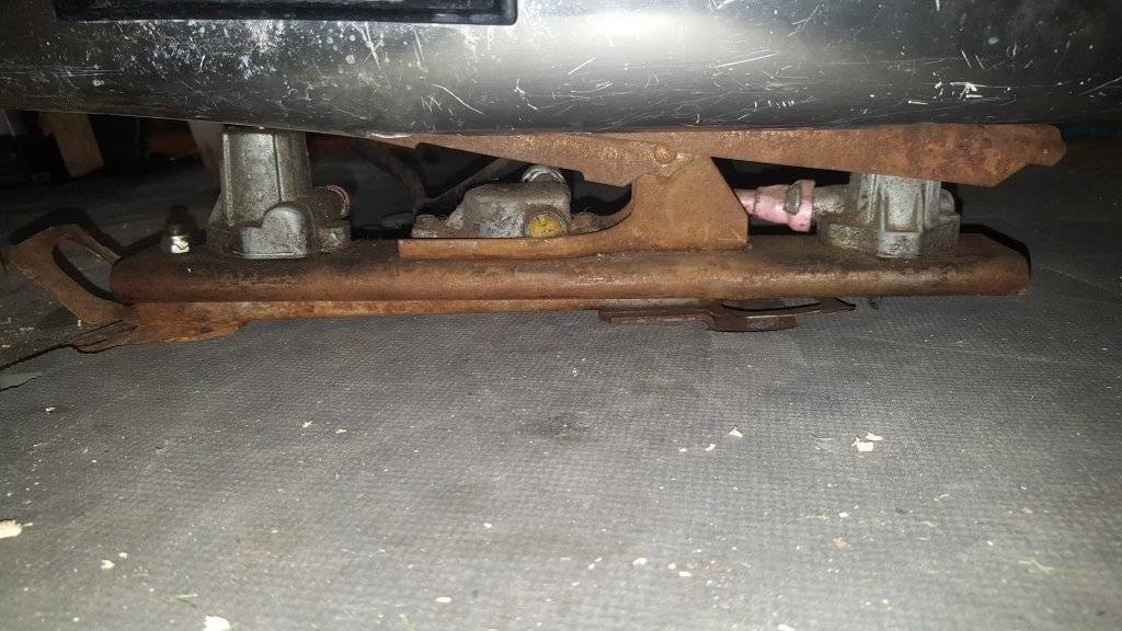

I have a front bench seat in a 1968 fury III fasttop. the seat is motorized, but has not functioned since I got the car.
Has anyone goofed with the electricals/motors/etc? Can I take a drill and wind the adjustos manually?

First check for current to the switch harness. The cables can be turned with a drill motor once disconnected at the motor end.
Take a read through the FSM section on the seat adjusters. The electrical tests are pretty good.

so dude told me that the end gears are for up/down of the front/rear of the seat, and the gear in the middle is the <> front back adjust. dude says it works on a cable with a square head stabbed into the worm gear arrangement. he also cautioned that if i manual the gears with a drill or whatever - to try to keep them even between the left side / right side gears - or I may bind the seat tracks.. .awesome.
i do not think i have the wire harness - the best I could think of is to take my portable 12v power supply and hit the contact points on the relay box thing and see if i get any life out of this thing.
i dont even want the motorized bench, I just need to get the front end down, and slide the thing all the way back, and it will never move again.
