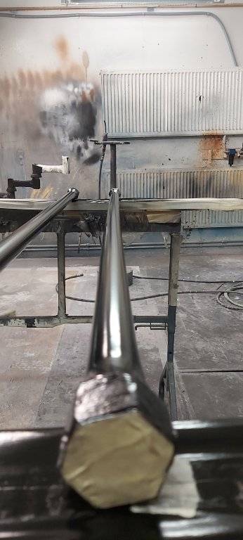

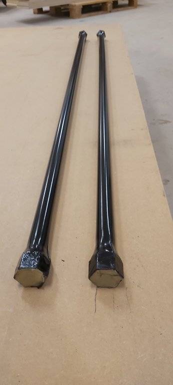

-69 Imp Le Baron, another torsionbar is bend about 3 millimeters ( 1/8 inch) , the other one is straight. Is it problem or not? Removing wasn't difficult.
It would probably be OK, but I would replace it. Probably best to replace in pairs... although if you find a used replacement the same diameter, I don't see as it would be a problem either, but others may disagree.
Chances are someone tried to jack it up under that T-bar.
If your going to replace, now is the time for a little improvement.
I agree with replacement.
I had one with the driver side torsion bar bent. Failure would be catastrophic to the car and maybe the people in it. They need to be replaced to stay on the safe side.

To me the question is - what does teh FSM or Chrysler's original quality spec say for allowable bend? (quality specs are likely not around anymore, they would be on an engineering drawing)
Are there any nicks/gouges on it (or the other one)? That's the #1 reason any torsional item will break - a flaw in the highest-stress surface.
You have a 1/8" bend over a 47"+ span - most people would never have noticed it.

In that case, if it were me, I'd replace the bent t-bar.

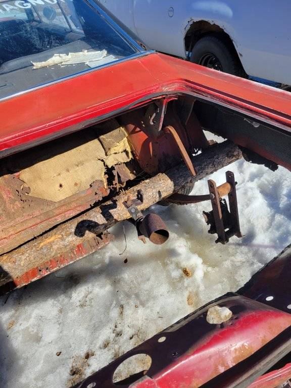

I have also never had one snap while moving, always parked, lucky I guess. I have had rotten torsion bar cross member twist out a few times.
Have had that happen myself. Kinda typical A-Body winter car issues.
It was always in the dead of winter... Snowing and very cold. The repair procedure was to drag the floor jack out, jack it up enough to jam a short piece of 2 x 4 between the lower control arm and the frame. Then drive your cold *** to work where break time now included looking through the newspapers and Auto Traders for the replacement car. Although... I did have one welded up... The "pros" that did that fitted a nice U shaped steel piece around the anchor... But then they hacked off a piece of angle iron and welded it across to the other anchor. That car lasted a while after that.
Been there, done that. Wood chunks to keep leaf spring though trunk from coming back though.
