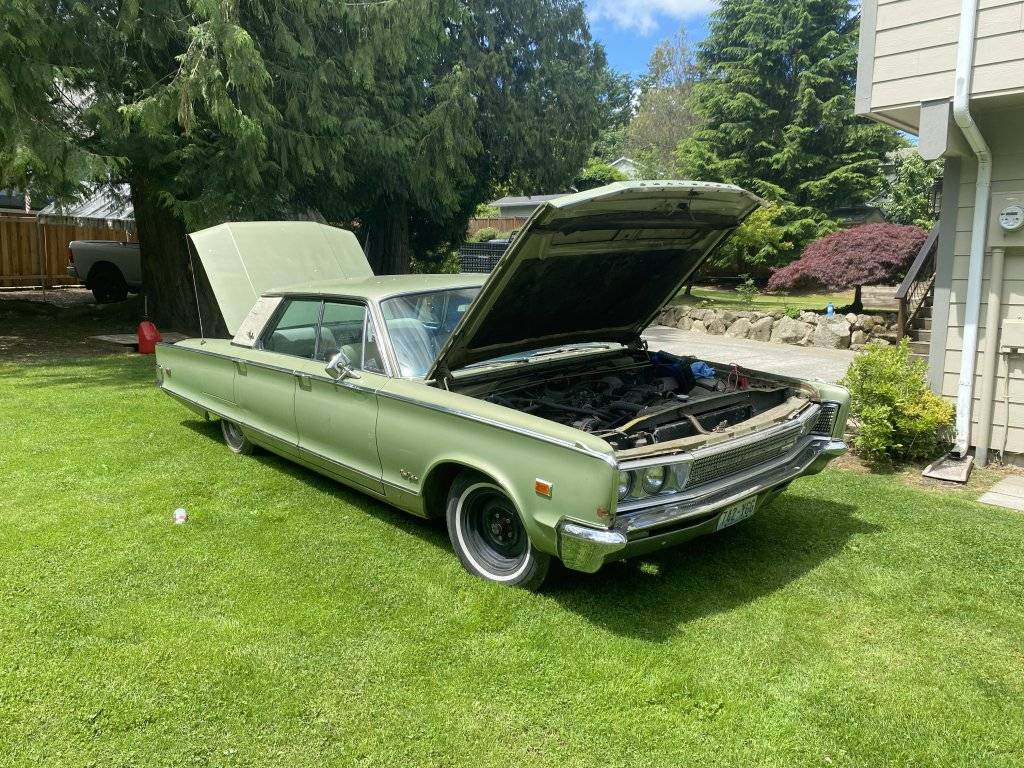

Hello everyone, I recently picked up this 1966 New Yorker, and unfortunately she has a bent pushrod on the #7 intake. The car had been sitting for at least six years before my father and I bought it. The car drove the seven or so miles back to our house. If anyone has any tips on replacing the pushrods in a stock 440 I’d really appreciate it. My dad is also interested in why this might’ve happened, so please chime in if you have a hunch why.

nice looking car though! :thumbsup:

That looks like a fairly decent car to work with!
It's already been driven 7 miles home, so there's no need to concern about damage, what's done is already done.
