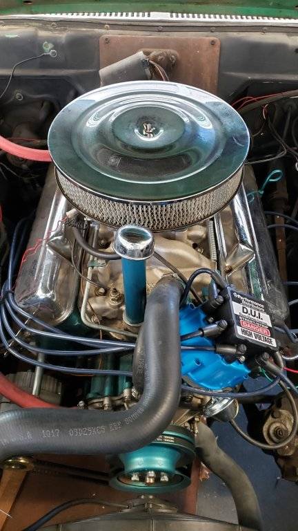

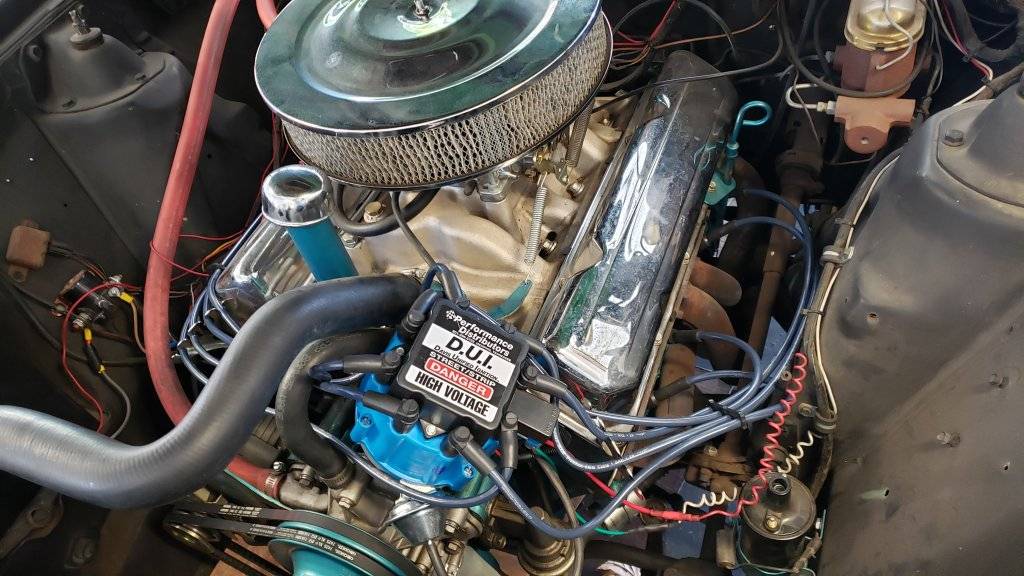

AMC used GM distributors. (Ford electronics and starters, and after '71, Chrysler Torqueflights.) When we built the 401 for the Gremlin we bought a new points Distributor and installed a Pertronix ignition in it. I never liked it. Even found at one point it was coming apart inside the cap!
A few years ago DUI started offering HEI distributors for AMC. I bought one and installed it recently. WORLD OF DIFFERENCE! At this point I do not see that they are building them for Mopar, but if they did I would highly recommend!!
