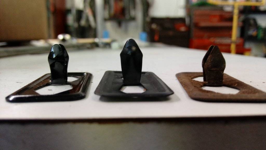

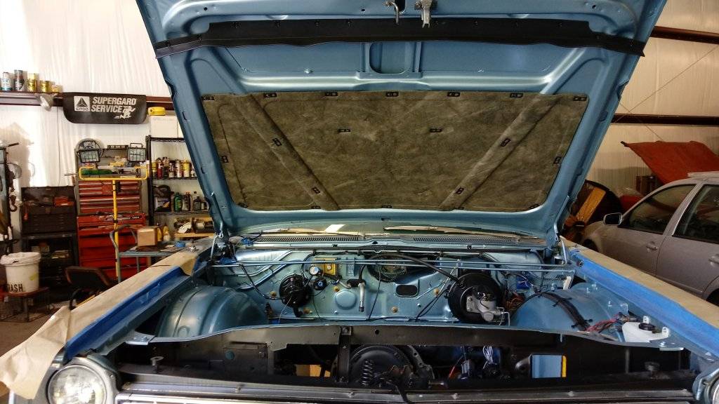

ok I bought the one from Mopar Mall...it is a REM unit and in spite of what they wanted to ship it on their website they drop shipped it from REM for less...that being said I hate it...it was packed between 2 huge pieces of cardboard and the bag of clips was thrown in between them and damaged the face of the pad...it comes with the holes for the clips pre-punched...except they're not all in the right spots...and there's extra ones punched in it probably to fit something besides a 68 so if you look close you can see them...I needed to trim it shorter, and drill 2 new holes in the 2 front corners of the hood to line up with their holes...the clips that come with it are worthless...they are not spring steel and are too short so if you do actually get one in it will fall right out...i was able to get clips from Detroit Muscle Technologies that actually worked....it's made of very short chopped fibers and barely stays together...in spite of its molded ribs it hangs too low...I have an Edelbrock Performer on my 440 (5/8 higher than stock) and a Mopar Performance stock style unsilenced air cleaner and even after buying a one inch dropped base from Mancini it still hits the pad and started to destroy my pie tin so I cant put it on till I get to the show...and its wearing the wrinkle paint off the air cleaner itself...the car originally had some sort of generic fiberglass pad spray glued the bottom of the hood and everything cleared with the original air cleaner base...maybe if you have a 383 with a stock manifold or a small block you wont have these issues
looks good from a distance

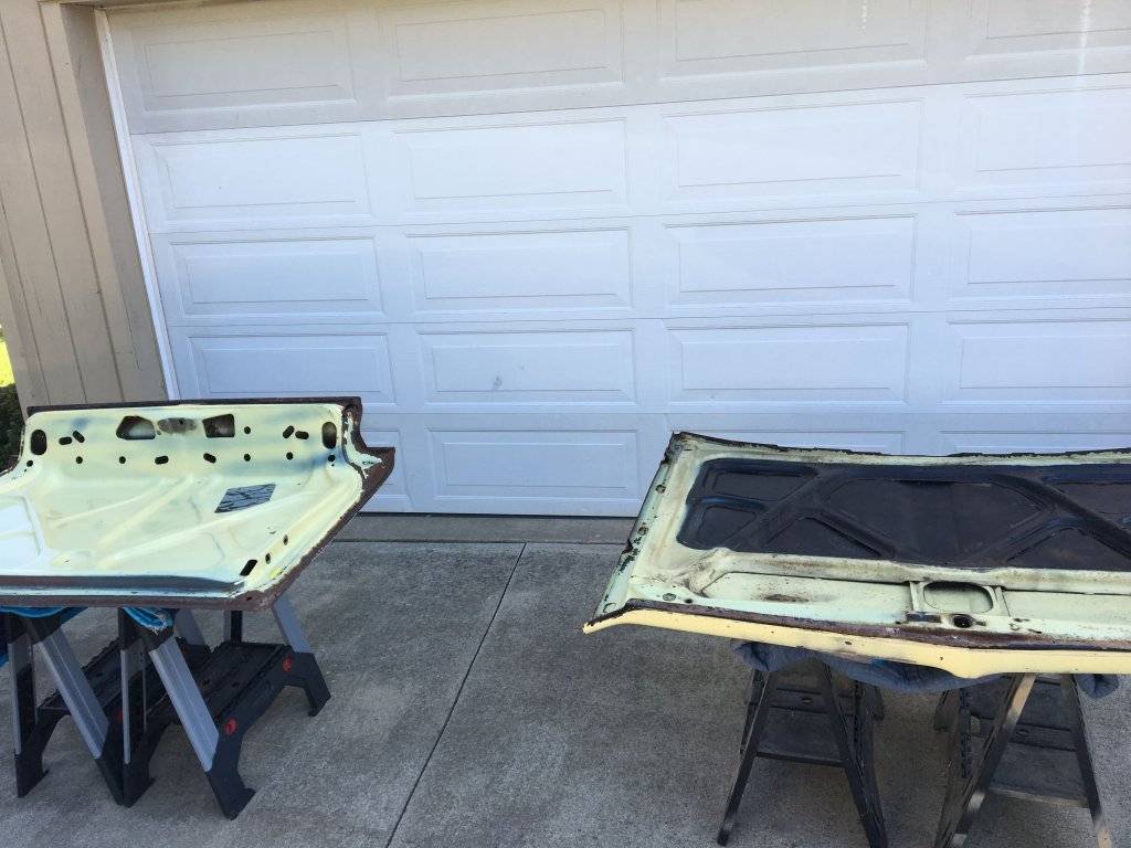

My car does have undercoating and the real tell is they never removed it to repaint the hood so it’s pretty obvious it used to have one :rofl:

Thankfully I still have the stock steel spring clips so I don’t need them thrown in to ruin it and then not even work to hold the thing on.

I had some stock ones but not a full set and they weren't long enough to make it through the thick pad...left DMT,middle REM,right stock
I purchased a REM molded pad through QQE and am satisfied. Re-used the OEM clips, many popped out but after tapping them in a little further, appear to be holding....
Mine was a REM as well. Yes very fragile until you get it installed and secured. Once in place I have had no issues. I did have a little corner damage but nothing major. If I recall correctly mine was a little too yellow so I did a little touch up with dark grey paint I do seem to be missing two lower corner clips the pad did seem to be a little thicker

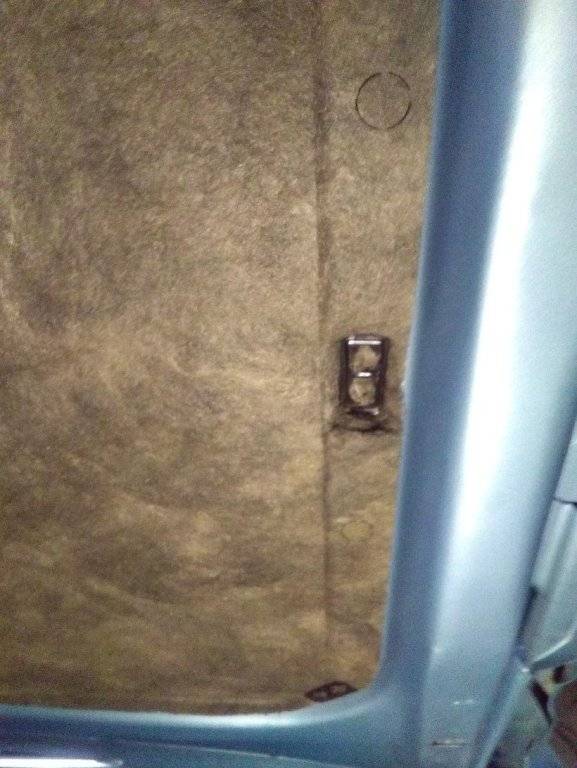

Here are some of the pre-punched holes that aren't used...there are 14 extras of these...just measured off another 68, the bottom of the pad is 2 inches below the bottom of the hood in the raised section down the center and 1 1/2 below the flat part or the hood
