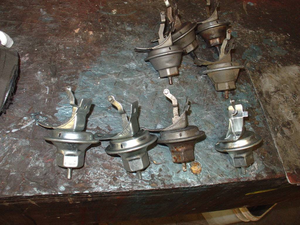

Got a pic of it where it mounts to the plate might have a used one. There are two different angles and a ton of degrees it can be.

Thanx bro. Damn things are common as rooster teeth. I have the OLD Chrysler original still myself, so I might try a look at that. Thank the Lord Chrysler Corp Motor Parts DOCUMENTED their work so well! I found the part number(s) in the 66 catalogue. Looks like I might do just as well to just buy one of the NEW Cardone 84-3817 jobs from Rock. People charge MORE for a damned NOS pot than for a complete distributor rig! That's just crazy. Mathilda just PURRS when I bump that starter over and idle her. She really runs so well even now that it never OCCURRED to me that the vac advance was DEAD. NOW, if I can just get that damned tranny rebuilt.....

Here are some of the styles I have if needed, yes a old one is a crap shoot along with NOS Mopar that sell for over 100. Seems like standard stopped making BB ones a few years ago and most rebuilders just clean up what they have and set the distributor to work in a span of around 10 years it seems. Getting one off a parts store shelf can be great or bad if the curve is for a smog motor and yours is a HP application. I know when I gets cores in with no number tag, it is a rebuild and just strip them for parts.
these might help. They have been cleaned up since the pic was taken except the NOSS.
Thanks! If they hold their vacuum and pull, thats the main thing. My old 383 is pre-smog, which is the motor I'm immediately concerned with though the 77 400 I got is FULL smog, complete w the little Holley on it. I'll rebuild it by and by, or rather buy and buy I reckon. What do you want for one of those pots?

25 for the used shipped, which arm do you need the "curved" one or the "straigt" ones, they are stamped 10 l which is actually doubled so it gives 20. I liked up your curve and I think it was 18-22 vac.
