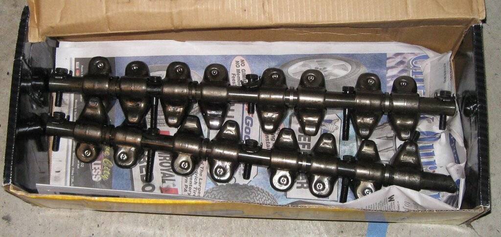

Wasn't really actively trying to sell, just some stuff I have lying around that I need to sell eventually. Say $25 or so plus whatever the ride is. Don't know where the end retainer/ bolt is, would have to look for that. No obligation of course.

@PH27L7 - those look great, and that's a generous offer for sure! I'll keep you posted.
