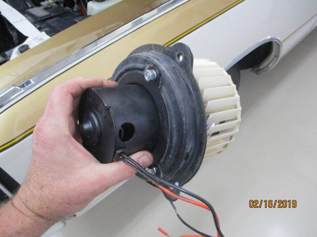

Also: I'm using the aftermarket (Rock Auto--Four Seasons #35563) blower, and it's okay I guess. A little loud, IMO. Price was great vs. an unobtanium NOS item. But note that the Rocky blower (i.e. the unit for my 70 300) has several mounting variations depending upon the application and probably even the brand of the car or whatever else it could be used for. The mounting flange, the bushings, the bolts/studs, the cooling hose, the location of the impeller on the shaft.....all allow the same motor to be used for a number arrangements. Not that this is bad, but it wasn't a direct bolt-in. You need to study your old blower carefully when prepping your new aftermarket kit.
