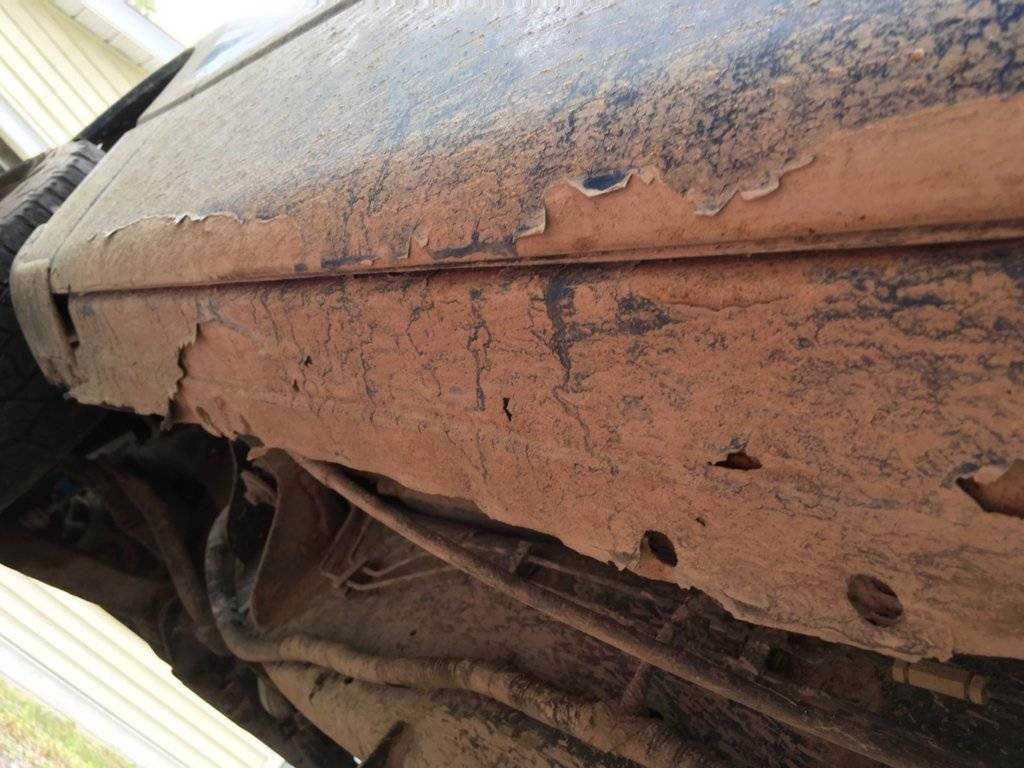

Holy Ford do f150 rot out sills rapidly.

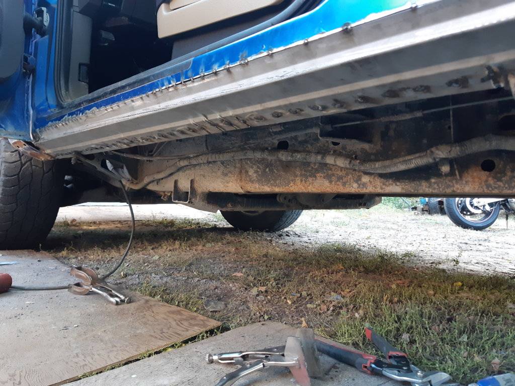

Helping out a friend.
Ford wanted 600 for dr side
2700 for pass side

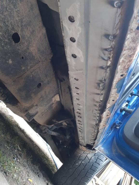

Had 18 ga inners bent and 20 ga routers bent locally for 100ish
Outer tacked on and will be finished today.
Goal is rocker guard around bottom edge of truck so not too fussy of finish

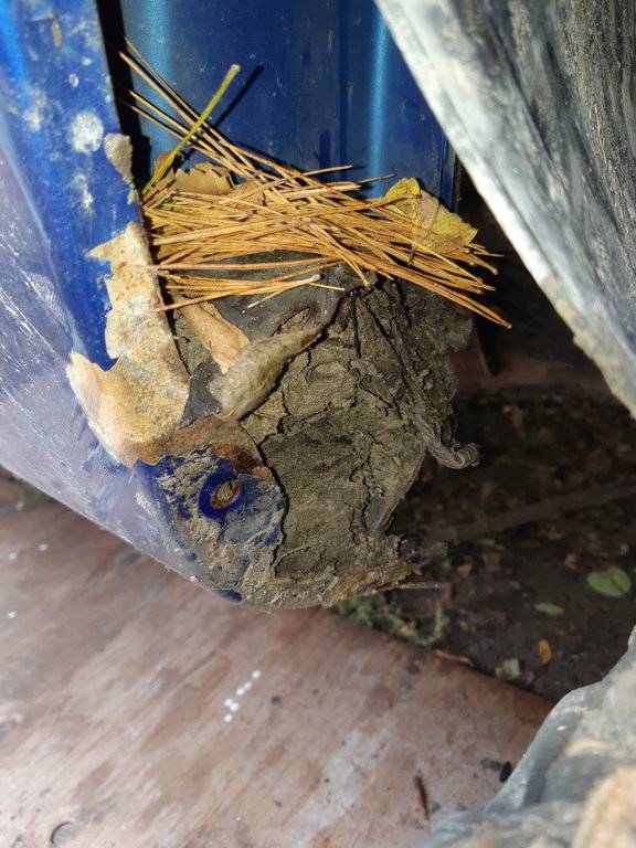

Pic of it clean wont load but this is what was residing behind inner fender and along sills. Going to drill for plugs to allow cleaning and oiling. This is a 2010 f150

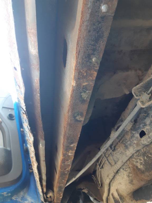

I have no doubt if cleaned and oiled it would still be fine. Oddly ford taped over access holes inside rockets. If you dont go in there you really cant get oil in deep.
My recommendation to him is we drill a few drain holes in outers and leave access to inners. Wash and oil spray regularly after that.

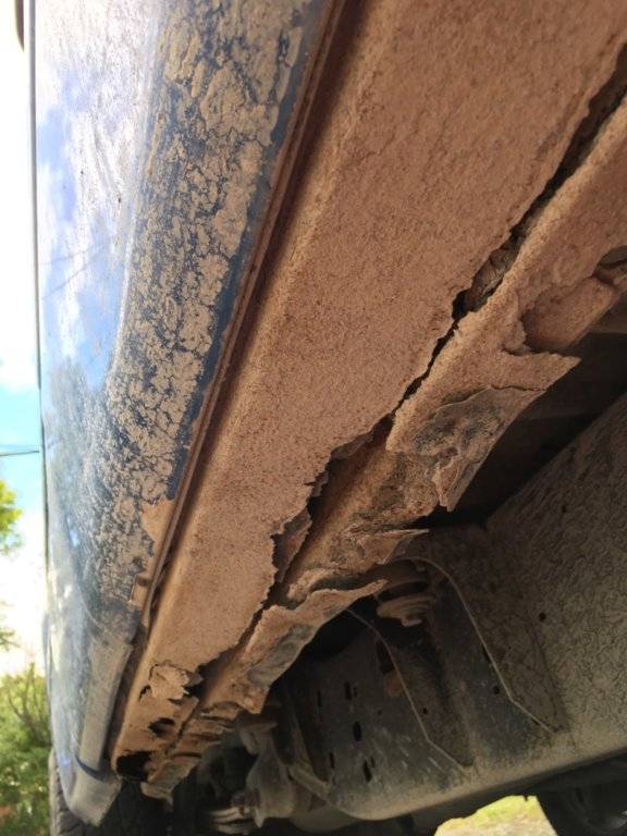

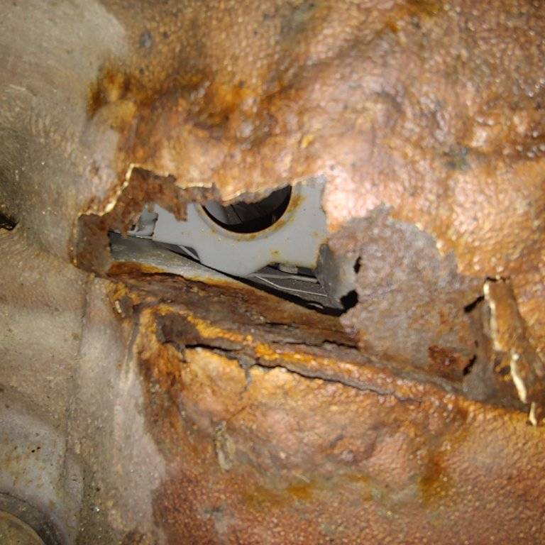

I can almost fit my whole hand in this rust hole in my Toyota daily driver, I already have the equipment to fix it... Hope to get it fixed (patched) before winter
