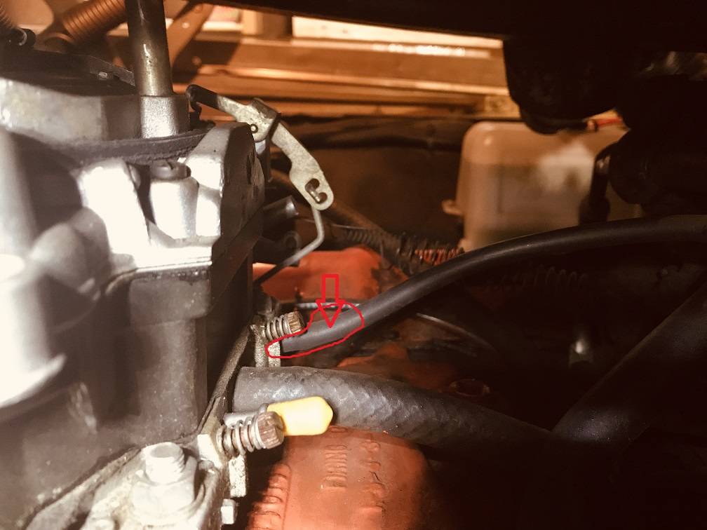

Just noticed the elepant in the pic. Change the vac line onto the other nipple you are getting full vacuum advance from the start.

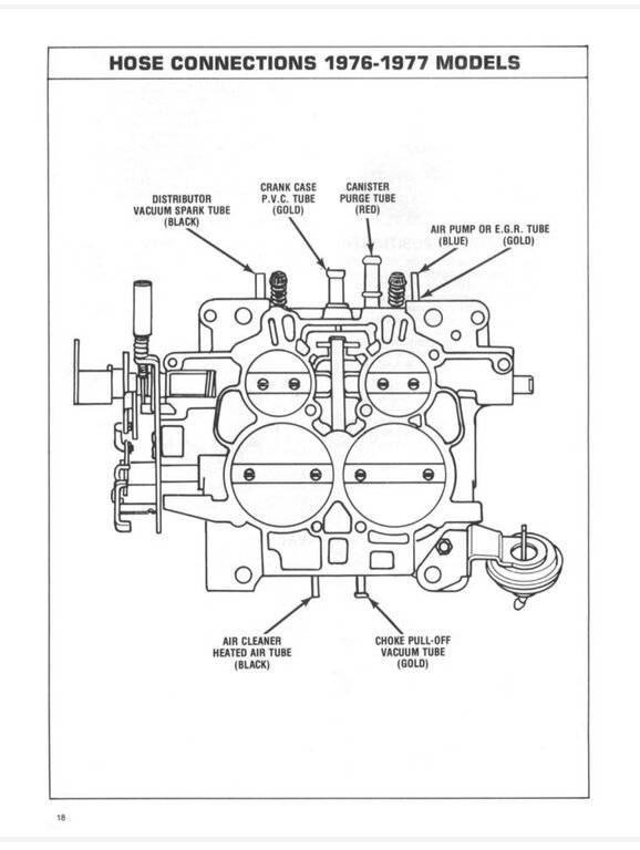

Your current vacuum connection is correct and is PORTED vacuum (says 1976-1977 but applicable to earlier years):
