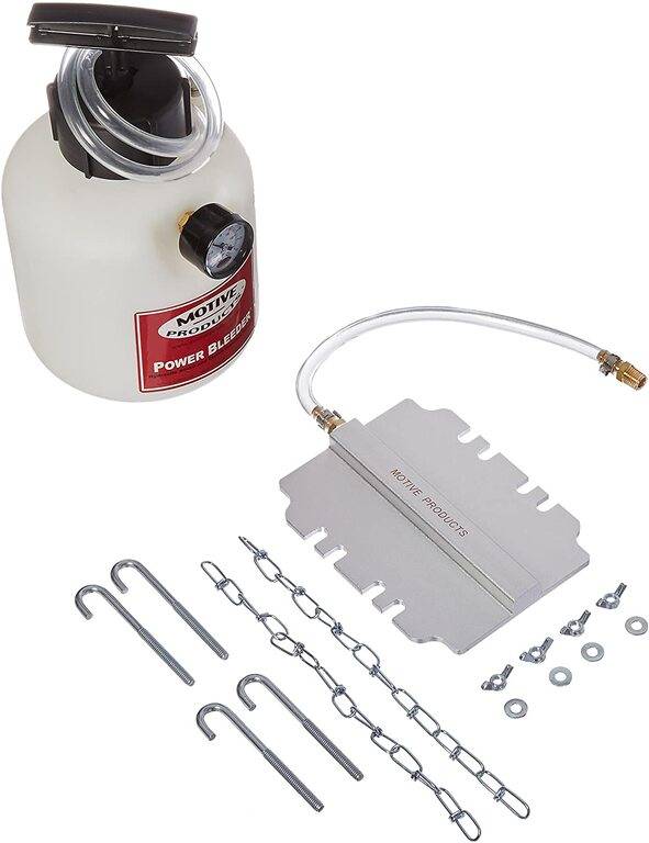

I did brake down (pun intended) and buy one of these last year. Shoulda bought one years ago.
https://smile.amazon.com/gp/product/B00CJ5DY16/ref=ppx_yo_dt_b_search_asin_title?ie=UTF8&psc=1
