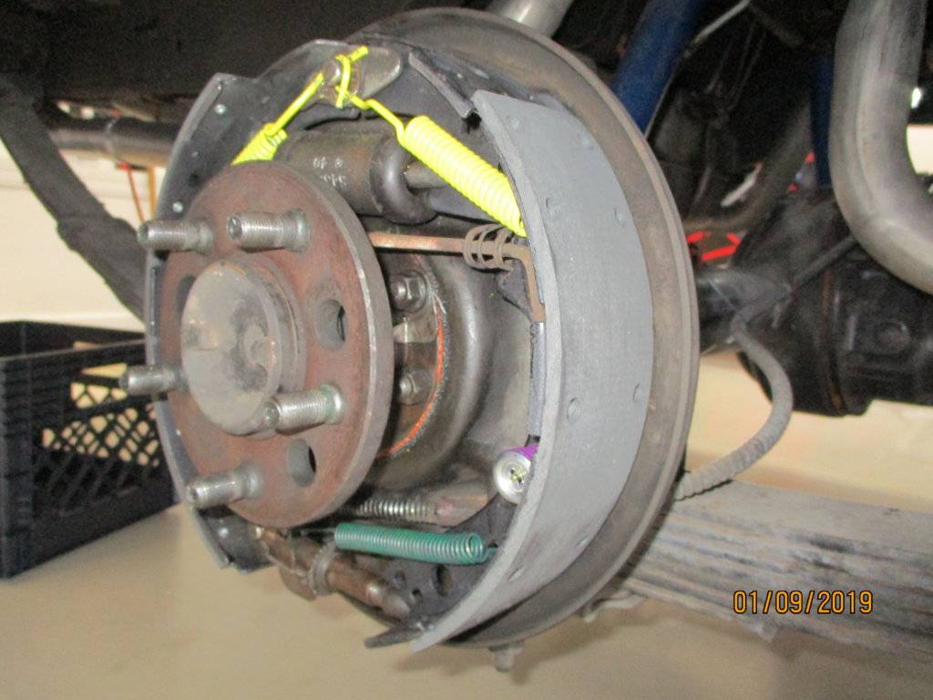

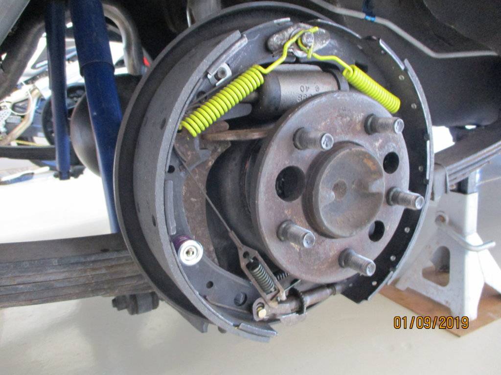

I just installed the "reduced diameter" cylinders that Richard Ehrenberg sells. They look very USA, like they just came out of a dealership. I also bought his riveted shoes and "not AutoChinaZone" return springs. He doesn't sell junk, that's for damn sure. His prices for good stuff are reasonable, too.
As for the reduced diameter cylinder, the intent is to REDUCE braking force in the rear to avoid lock-up and the ensuing swapping-of-ends of our long cars.
