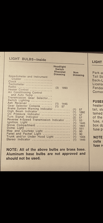

My 69 owners manual says use only brass base bulbs , however I can’t find any? Will it hurt to use todays cheap bulbs?

It's the dissimilar metals thing, and for whatever reason, compared to brass base bulbs the aluminum base bulbs react very poorly over time and corrode themselves into a big non-conductive hard to remove mess.
