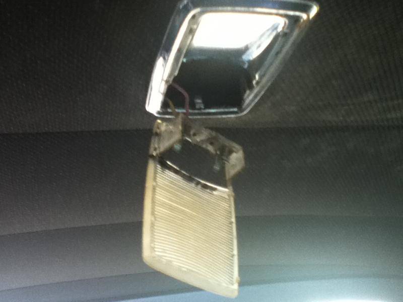

Well this is a first for me, never had to deal with any electrical gremlins before. Situation: 20amp fuse protecting the brake lights (also protects door buzzer, dome/interior lights, etc.) is continuously burning out. I know the fuse has popped when I open the door with key still in the ignition and the buzzer is silent. Any suggestions as to where to start looking for the fault?:silent:

Damn, I was afraid someone was gonna say that. Wishful thinking hoping there was a common problem/spot among fuselage cars, but thanks.......already got a test light.
Ahhh, found the culprit. Frayed wiring just touching the framing around the fixture itself.
