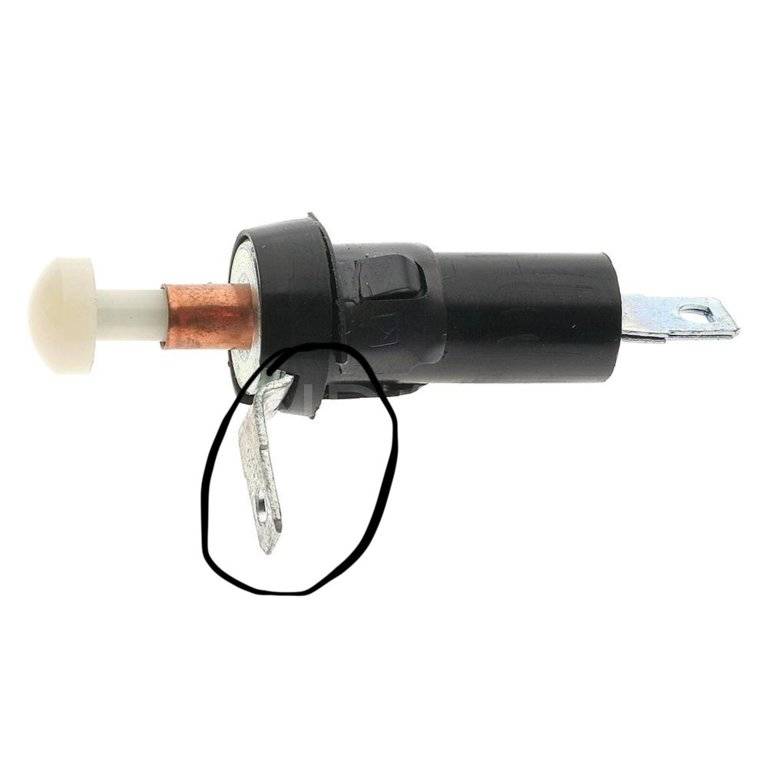

    trying to figure out the best way to get the brake light switch removed.. it broken and I can’t get it off.. Ang suggestions..

    There are a couple of plastic push tabs on the switch where it goes into the bracket. You need to push them in to remove the switch. Since your current switch is dead, you can break the plastic case if you need to to remove it.

    Thank you I thought I had to remove something major.. and is it possible to move the brake pedal up more.. I just might add a screw so the switch doesn’t stay on

    I can't remember all the years any more, some had an adjusting screw to keep the brake lights from staying on. Field solution was to glue a small piece of inner tube to the switch head to gain tension on the switch if it still works otherwise.
