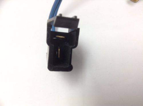

Is this a 4 connector switch? If so, If memory serves me correctly, I think GM and Mopar used about the same one. www.brotherstrucks.com still shows a listing for the GM pickup cruise control switch, which, I believe; is about the same one
(Ad shows a photo to compare) Photo of your switch would be helpful.

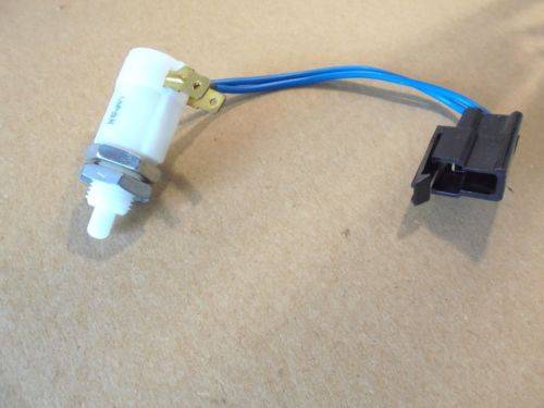

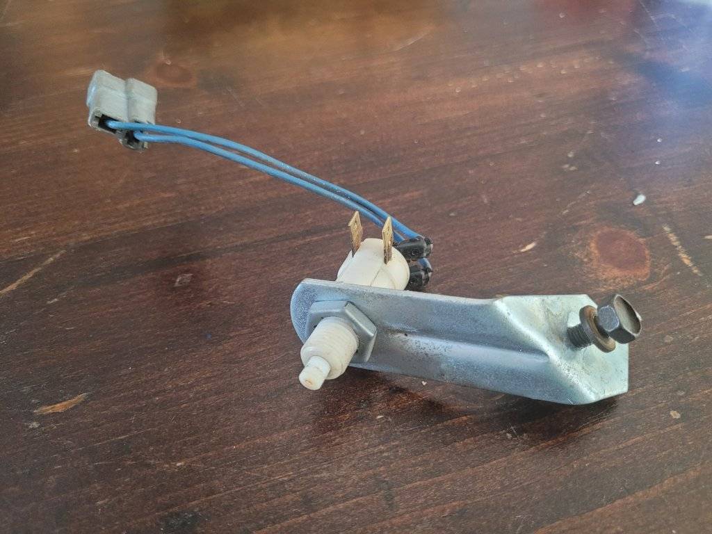

Guys, talking cruise. On the switch picture shown, is cruise the long wires or the pins?
YES. Best way to check is to use a multi-meter and connect across the two wires. You should have continuity across the two wires with the switch depressed. The reverse is for the two for the brake lights, continuity with the switch extended.
And Chrysler made a lot of this stuff fool proof by simply making a connection like this.

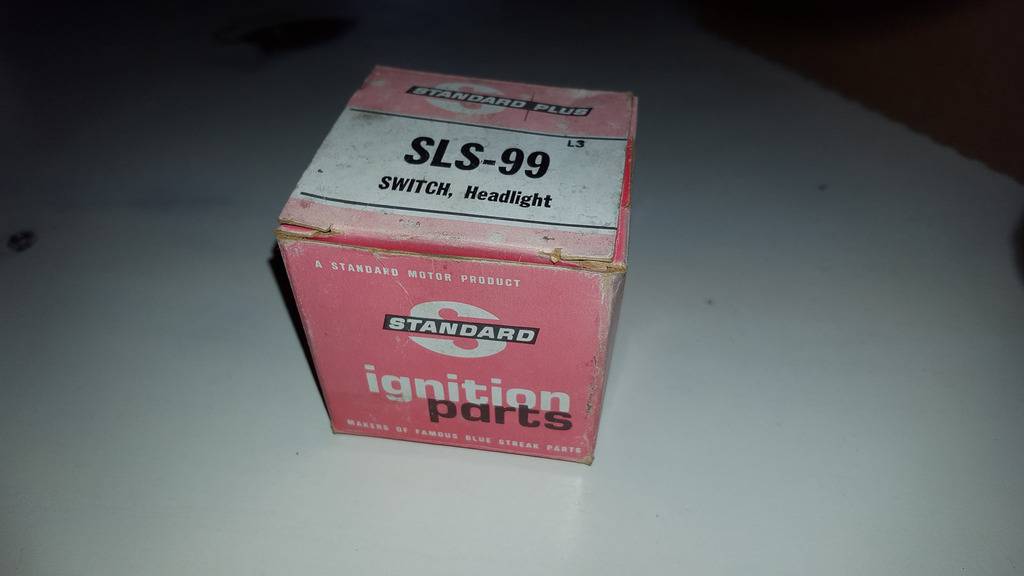

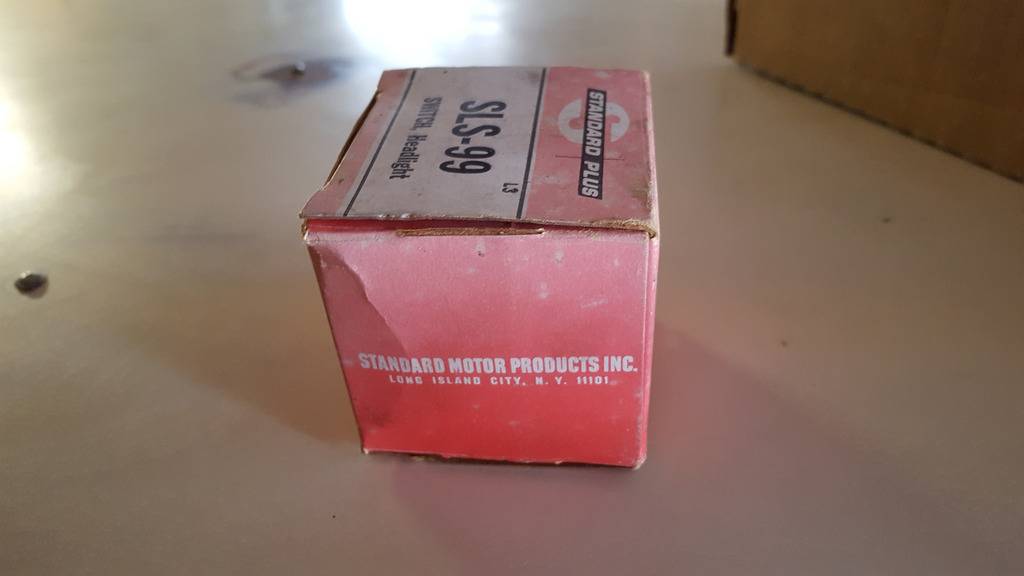

One of these suddenly popped up on Rockauto for $12, so I quickly pounced on it. Appears to be some vintage good old "Made in USA" parts. Not trying to prove or disprove anything, just wanted to share.

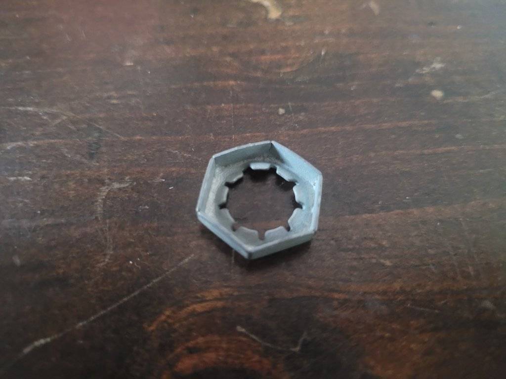

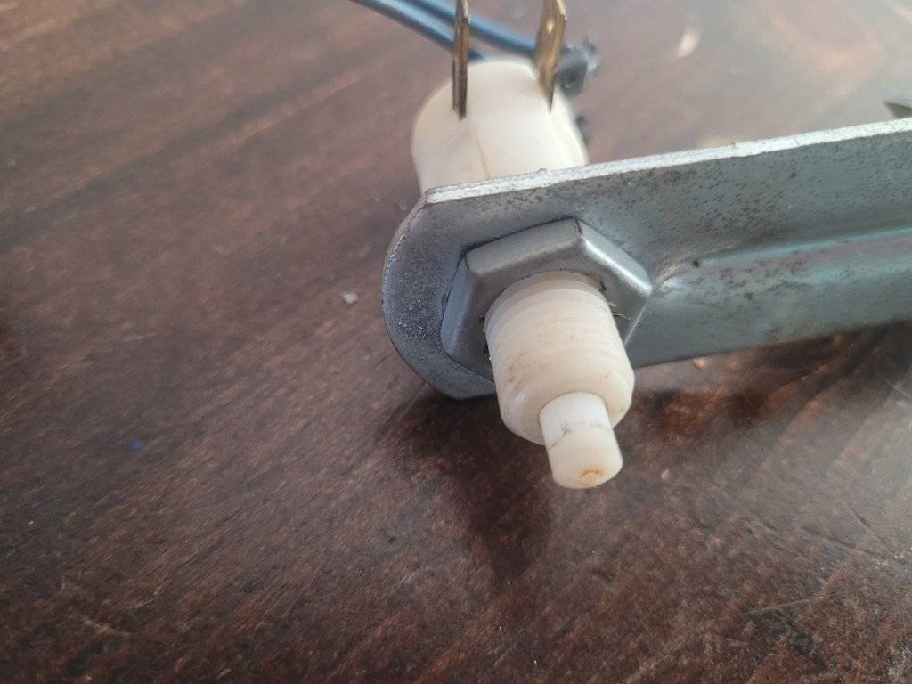

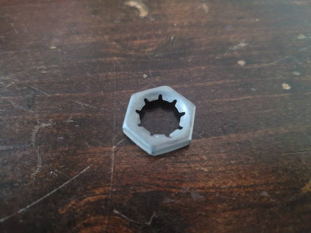

Has anyone sourced the nuts that secure the switch to the bracket? I believe they are called PAL nuts
