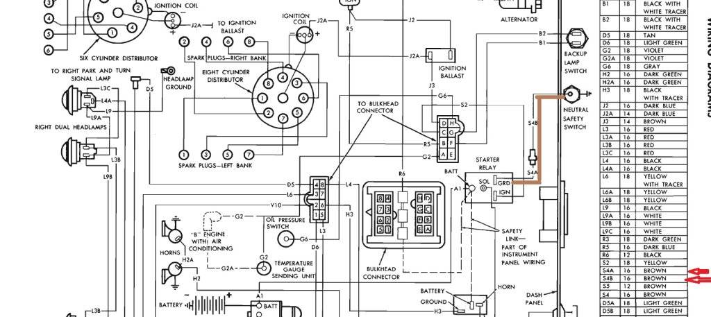

The simplest circuit there is the wire from the neutral safety switch, so I would look at that first. There's a brown wire that comes up from the transmission to the starter relay. That should be the only wire to the terminal on the starter relay or the neutral switch on the transmission.
