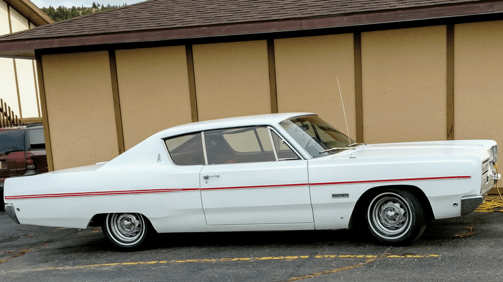

So I've been working on my fury iii I've replaced the blinker switch ( cam and harness) it fixed the first issue of no taillights blinkers etc. Then I was trying to fix my reverse lights not working (fabrication on the steering column) the switch is functioning correctly. Now the brake lights done work when pressing the pedal... ???? Any ideas appreciated Tia
