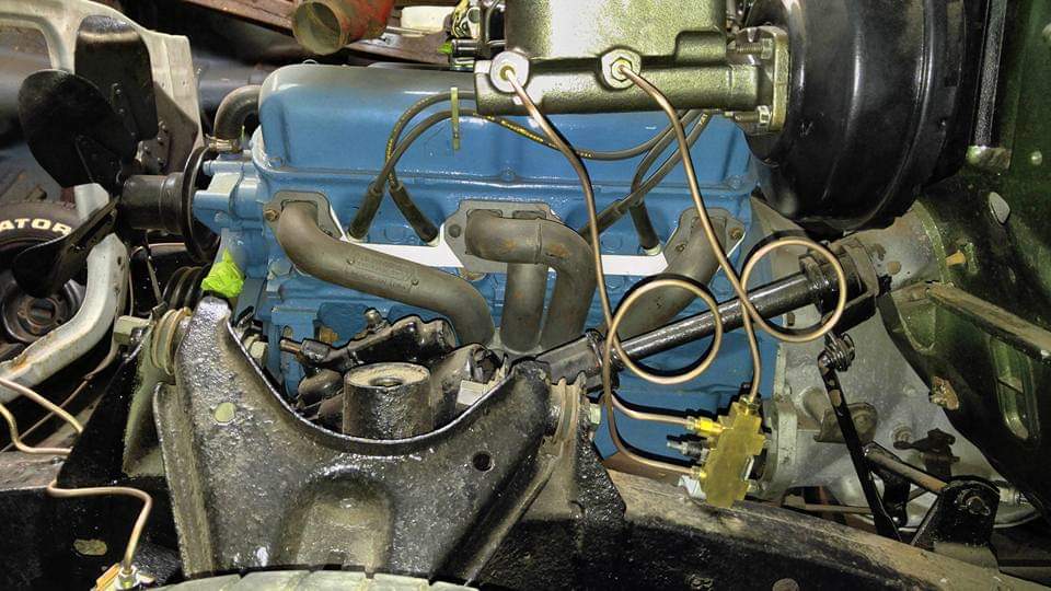

    Copper Nickel brake line is not copper...... It out lasts steel lines and is easier to work with...
    It won't rot from the inside or at fittings.....
    I use it for. Everything, fuel lines, brake lines, trans lines, etc...
    Nick
    • Agree Agree x 3
