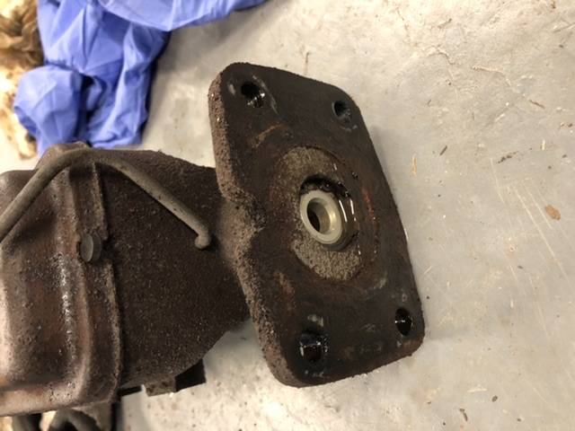

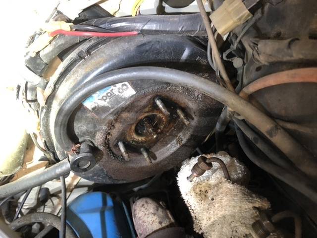

    I was losing a bit of brake fluid over time and the master and booster looked rough. Sure enough the master was leaking back into the booster and the booster was/is full of fluid.
    Getting the booster unbolted was rough. I think if I had to do it again I’d take the front seat out to allow for better maneuvering.
    On to installing the new parts tonight.
