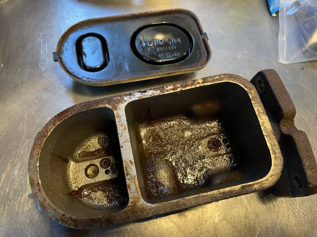

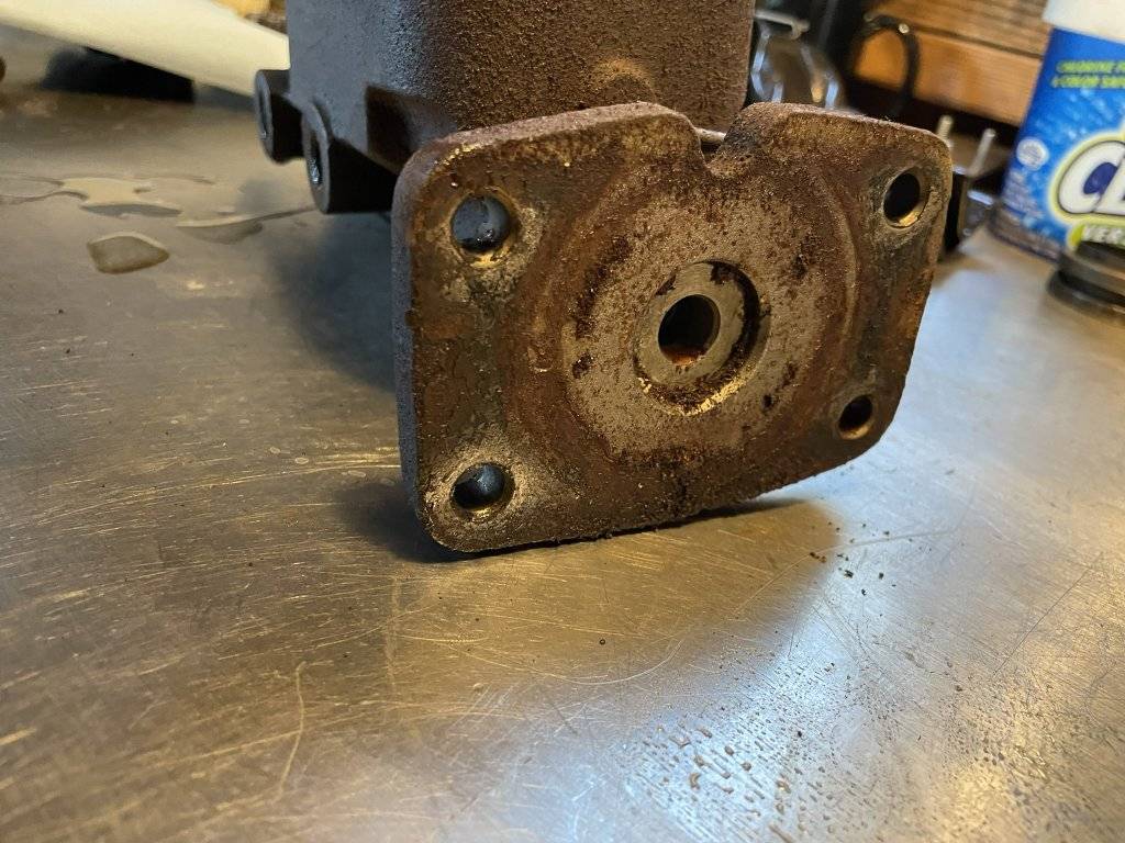

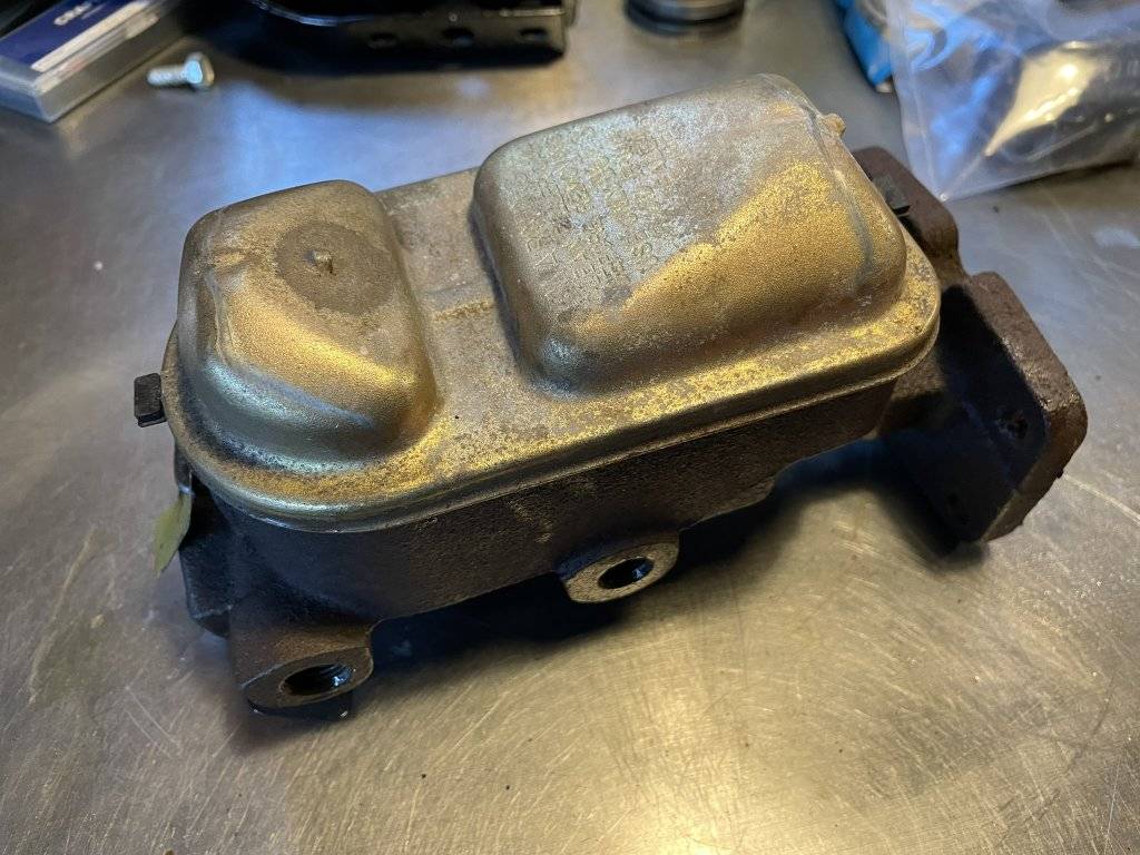

Original MC .... really not too bad for its age, if I may be so bold. I am looking for a rebuild kit. Any suggestions on supplier for this? I haven't found any yet.

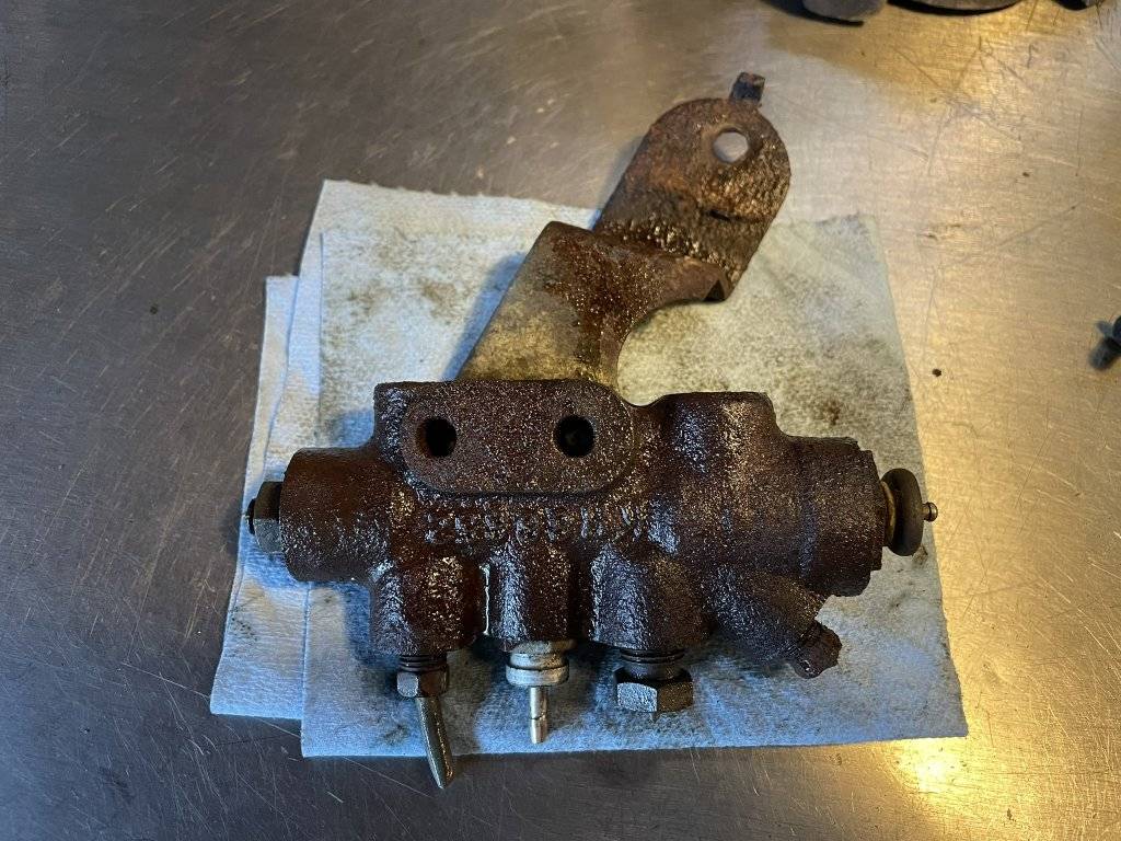

Disassembly and rebuild of the Kelsey-Heyes 86652 combination valve begins.......
This combination brake valve includes pressure differential and metering functions. It does not provide proportioning functionality.
Thanks to help from Muscle Car Research (as mentioned by @Boydsdodge above) for their excellent articles on disassembly and rebuild, and the rebuild kit.
Kelsey-Hayes 86652 Combination Valve Autopsy | Muscle Car Research LLC

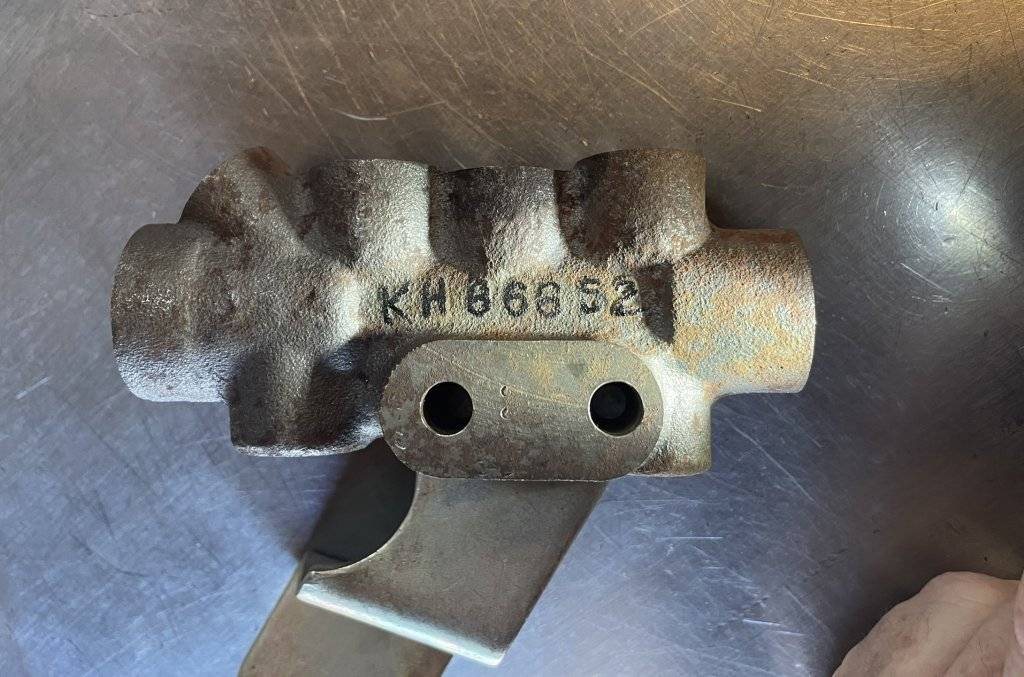

Here's the valve upon removal from the car. I'm replacing all the brake lines, so I just snipped them instead of going through unnecessary hardship and causing more damage by trying to break the rusty fittings free.
After removing the fittings and the end cap, I just began by soaking the entire assembled valve in Evaporust. It came out very nice!

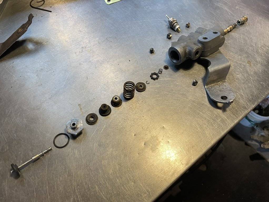

Now onto disassembly.
The brass seats were removed by threading them with a 6/32 tap and using a home made puller to extract them cleanly (as suggested by Scott @ Muscle Car Research).

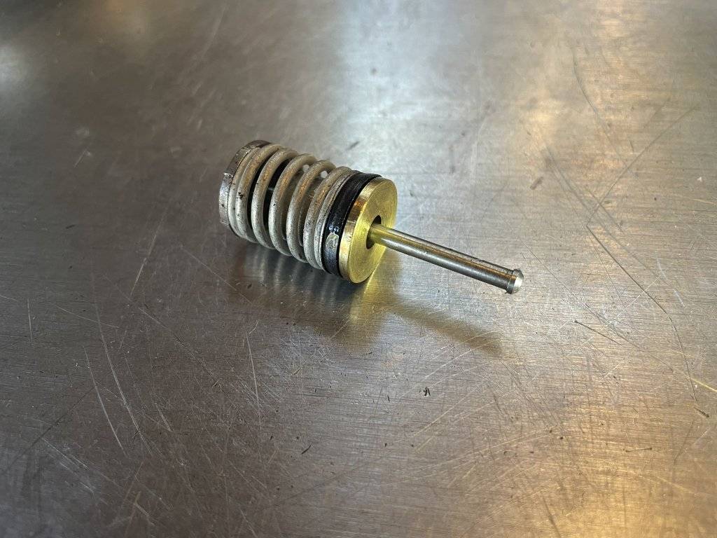

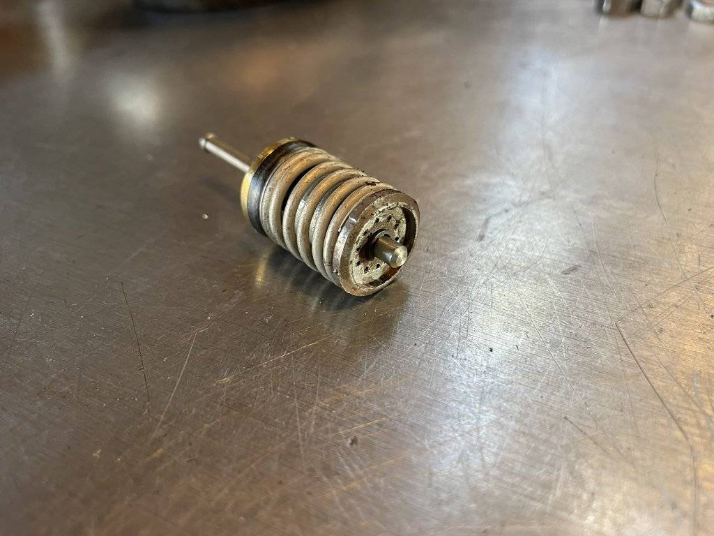

The metering valve end. The pin pulled out but the rest of the valve remained stuck.
Another improvised puller was used to remove the brass end cap without damaging it. With that, the remnants of the metering valve could be removed.
The entire combo valve disassembled, from the rear circuit outlet end:
From the metering valve end:
The pressure differential piston removed and separated into its components:

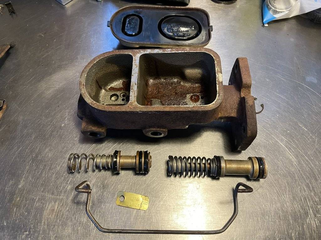

More on the OEM master cylinder.... inspection revealed that it needs to be sleeved. It has been sent off to Karp's Power Brake in Chino, CA for a new SS sleve.
A rebuild kit is on order from @mobileparts, who is also a regular customer of Jeff @ Karps, going back decades.

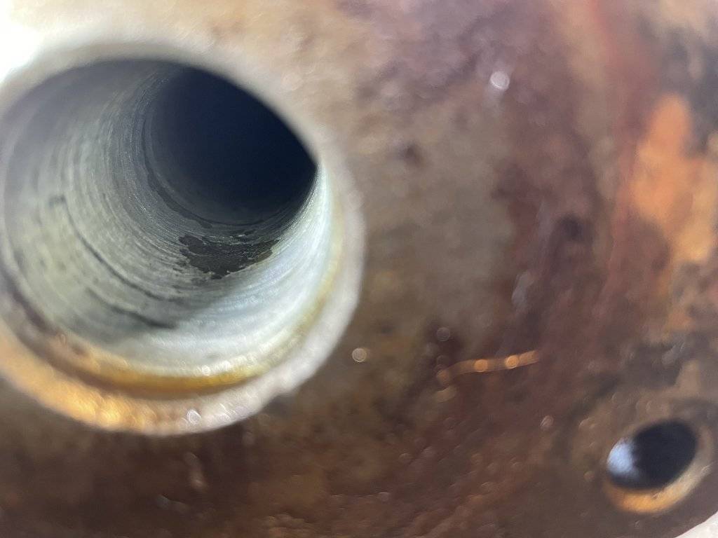

Several strokes of the cylinder hone revealed the pitting below:
Once again i hadn't planned on getting into the brakes quite yet. But closer inspection revealed more corrosion that I was comfortable with.

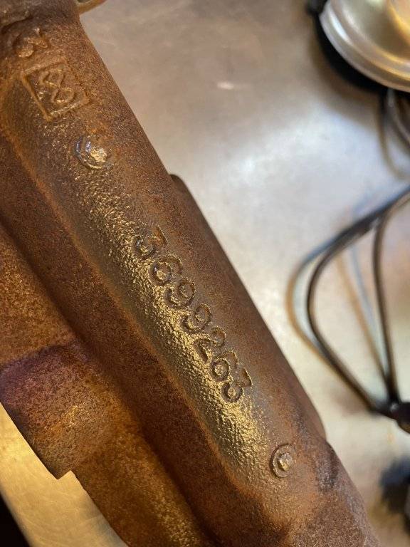

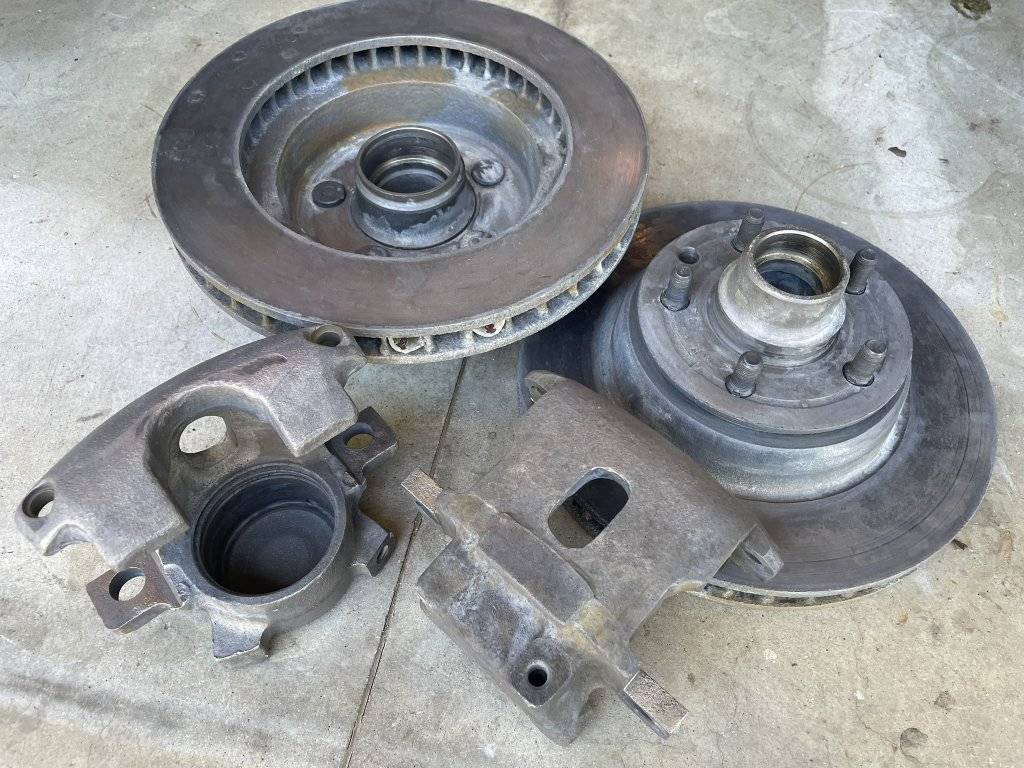

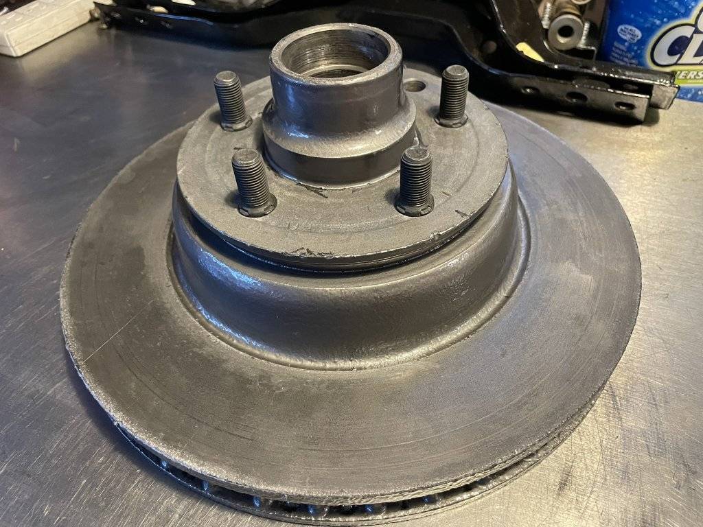

The rotors... now I'm not sure if original or not - I don't see any p/n cast into these.
Look at that rust.... would you just look at that.

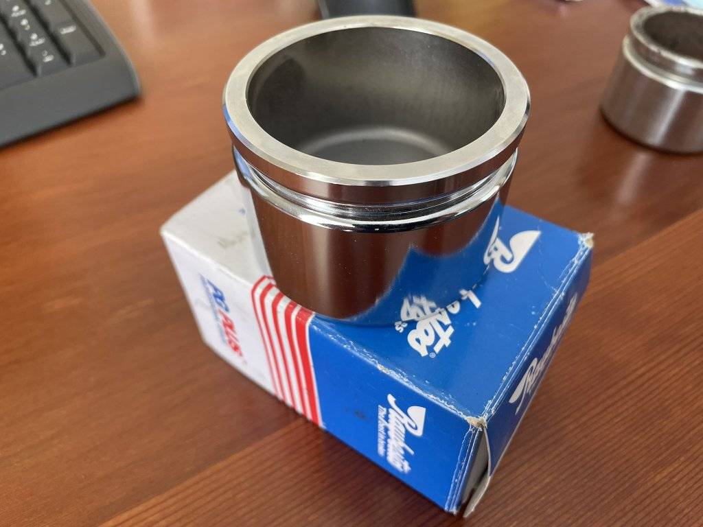

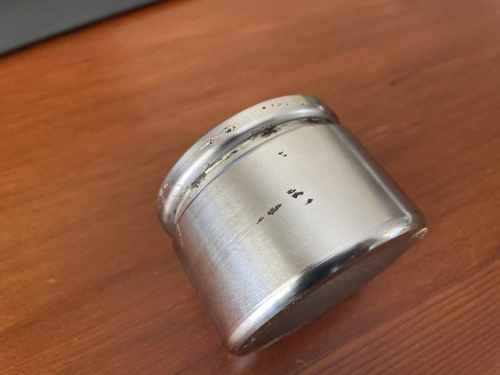

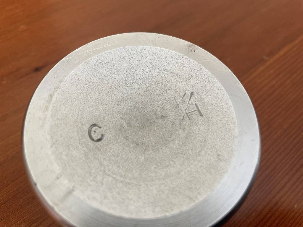

The pistons have their Kelsey Hayes stamp, so the calipers must be all original. Pitting on the piston's finish warrants new pistons.

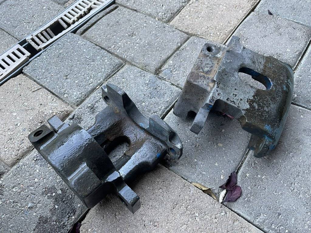

The calipers will be soaked in Evap-o-Rust.

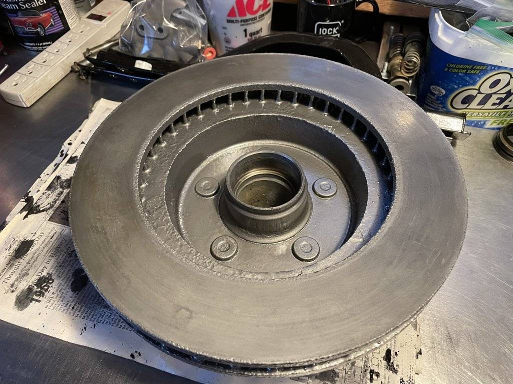

Rotors, hubs, and calipers rust abatement, using chelation method with help from Rust 911 (same process as Evap-O-Rust).
These were heavily caked with a thick layer of corrosion and took about 10 gallons of solution to get to bare metal.

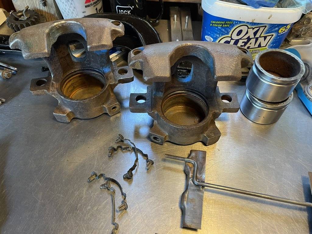

Half-way done on the calipers:
Complete after a few days of soaking. Rinse and wire brush with some phosphoric acid to treat the surface.

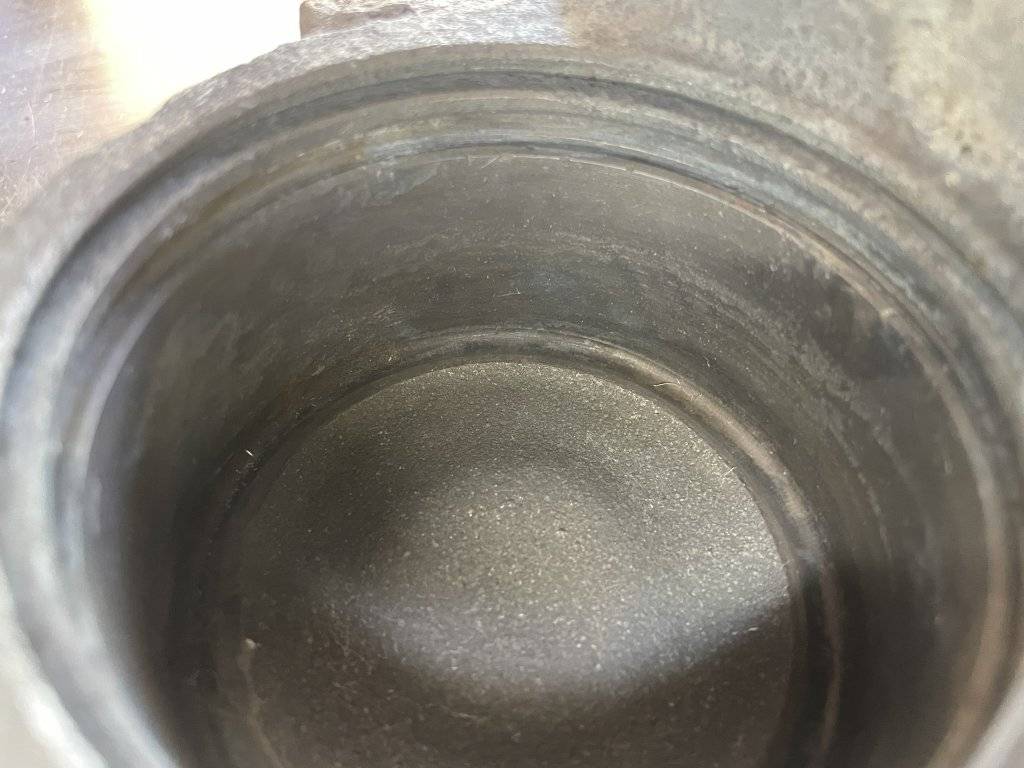

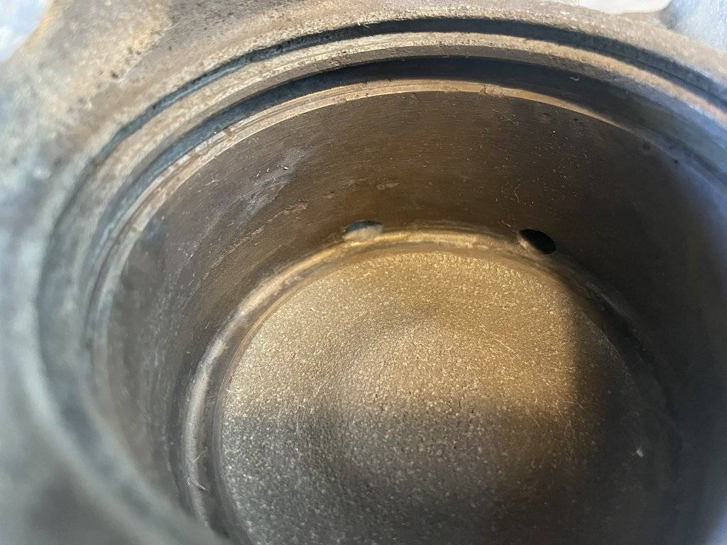

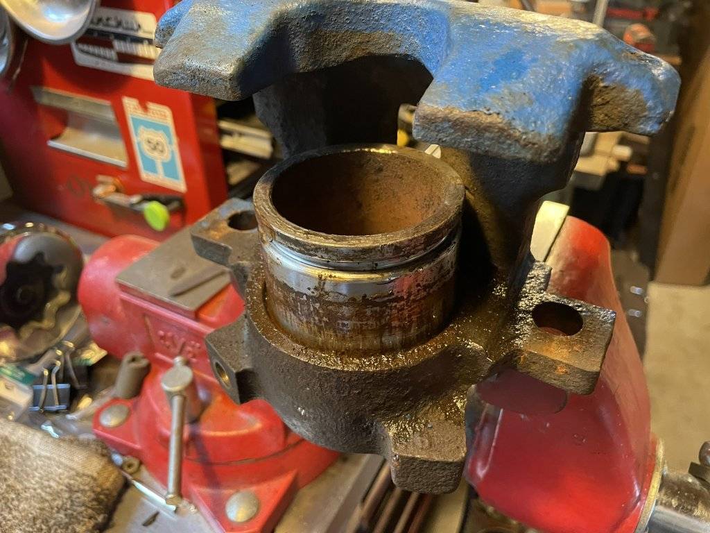

Caliper bore inspection - some pitting revealed, however the seal grove is not pitted.
I was going to send these photos to Jeff at Karp's brake for his opinion. not sure if they need sleeving, if that's even possible, or necessary. As was stated on the other caliper thread here, the piston rides on the stationary seal, the bore is to keep the piston aligned straight.
What do y'all think?
As long as the pitting doesn't result in scoring on the piston itself, it'll be ok.

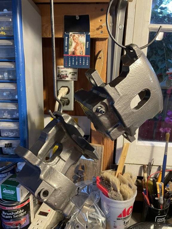

Calipers and rotors painted.
Two coats POR-15 followed by two coats Aervoe cast iron gray engine enamel.
I did not paint the wheel mounting surface this time. it will get a thin coat of oil or grease for protection. Also, the bearing outer races were compromised during the de-rusting process, so I will need new races now.
The currently most durable shop-applied paint combo I've found.

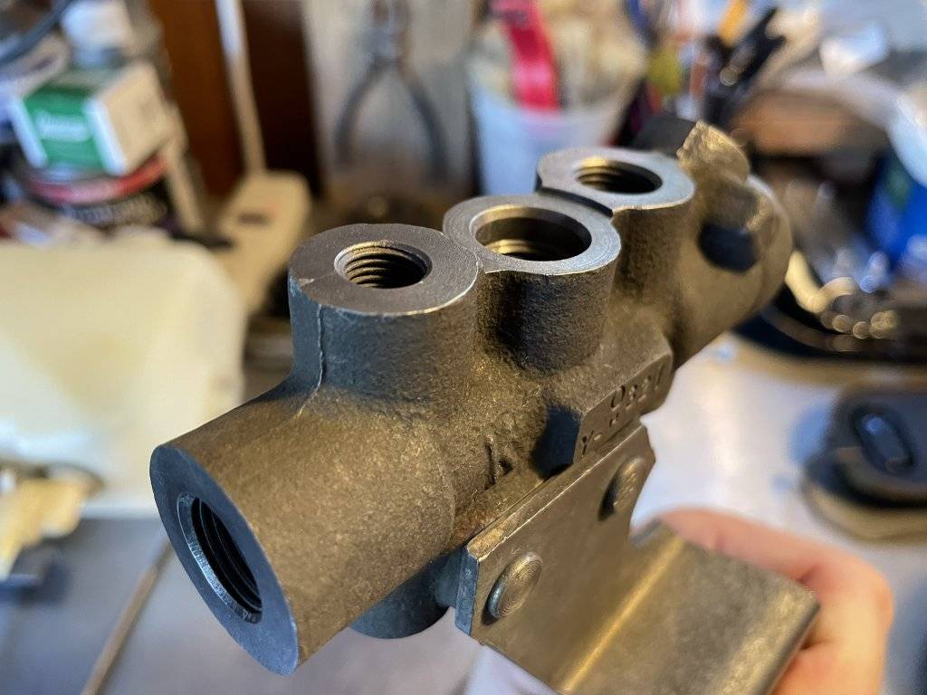

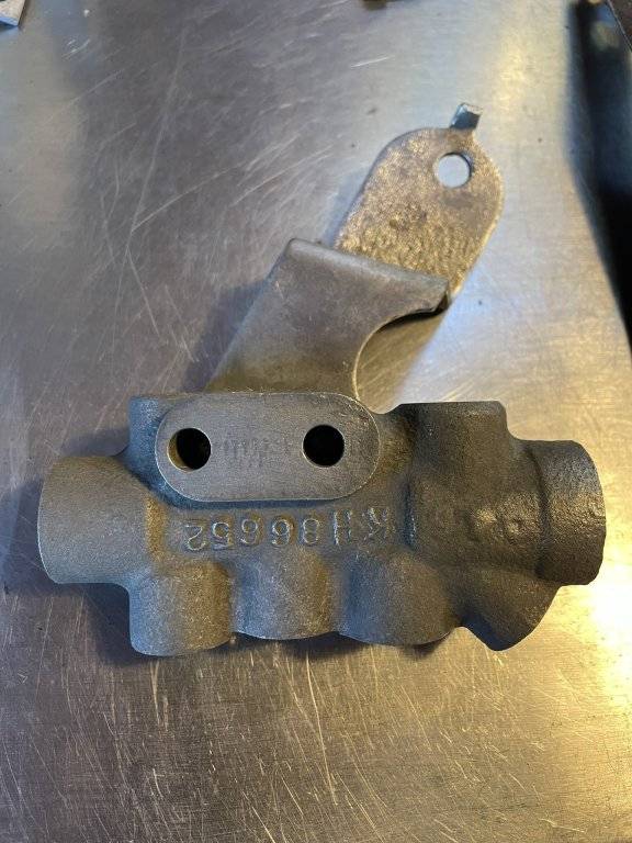

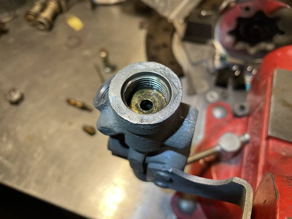

The original combination valve , upon completion of rust removal, had a lot more internal corrosion and damage than I was comfortable with. So I sourced a NOS valve from AMS Obsolete with the suggestion of @saforwardlook.
This valve is old as well, so I disassembled it for inspection and cleaning. It, too needs a light bath in chelation solution to remove shelf rust. I will zinc plate the cast iron body before reassembling.

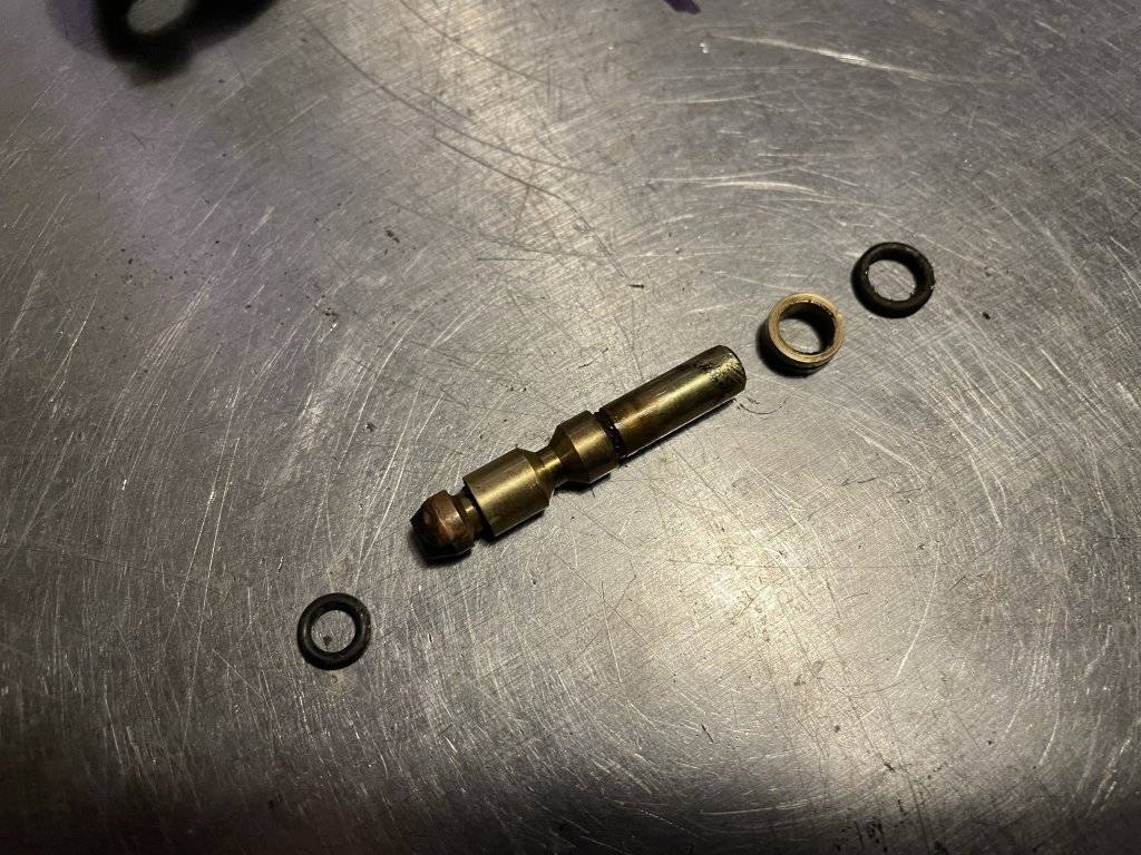

The internals are pristine:
